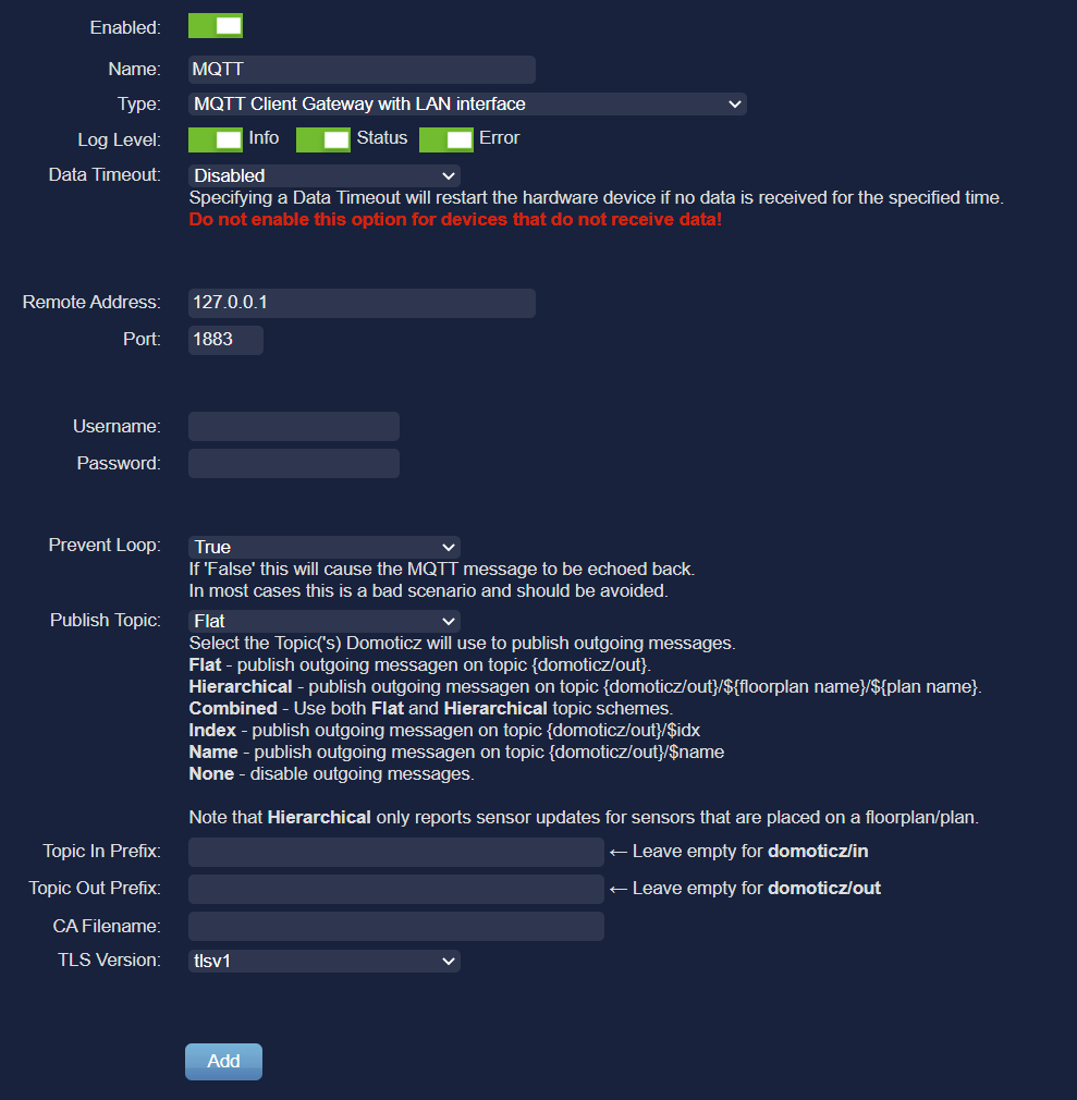

In the Hardware setup, but this is only valid for certain formats :
Publish Topic:
Flat
Select the Topic('s) Domoticz will use to publish outgoing messages.
Flat - publish outgoing messagen on topic {domoticz/out}.
Hierarchical - publish outgoing messagen on topic {domoticz/out}/{$floorplan name}/{$plan name}.
Combined - Use both Flat and Hierarchical topic schemes.
Index - publish outgoing messagen on topic {domoticz/out}/{$idx}. (with or without Retain bit)
Name - publish outgoing messagen on topic {domoticz/out}/{$name}. (with or without Retain bit)
None - disable outgoing messages.

Re: Can the MQTT Client Gateway post "retained" messages?
I'm sorry, but I'm lost.jvdz wrote: Saturday 02 October 2021 16:35
In the Hardware setup, but this is only valid for certain formats (?) :Publish Topic:
Flat
What you reported is what I see in the hardware setup, but where o I set the retain bit?
- jvdz
- Posts: 2476
- Domoticz version: 4.107
... by setting the Publish topic to one of the items that has (with Retain).Andrex wrote: Saturday 02 October 2021 16:41 I'm sorry, but I'm lost.
I have no idea why the other message types do not have the option to set the retain option, but that seems to be the choice made in hardware.html:

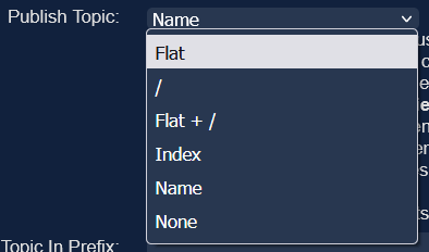

[quote=jvdz post_id=280344 time=1633185856 user_id=3281]
... by setting the Publish topic to one of the items that has [b](with Retain)[/b].
[/quote]
I'm sorry again...but in those items how do I specify that I need the retain bit?
This is what I see:
[attachment=0]chrome_KcZGCRAw60.png[/attachment]
P.s. I don't know how I broke the quote here...
[/quote]
This is what I see:
- chrome_KcZGCRAw60.png (58.12 KiB) Viewed 3392 times
- jvdz
- Posts: 2476
Click the Dropdownbox that contains flat and you understand what I mean..... but: I do not see the option to set the retain for the FLAT format in the html page, but assume it is possible when that option would be added or we know what the JSON call looks like.

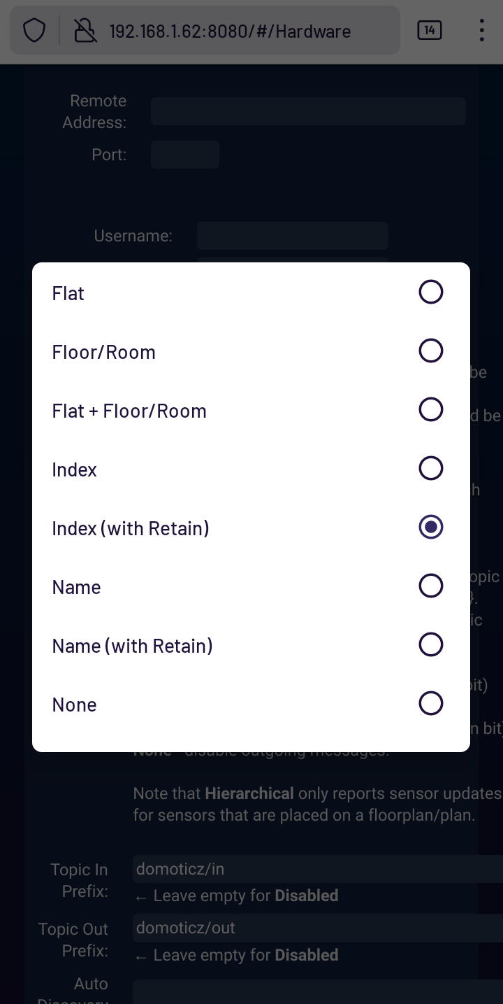

- kiddigital
- Posts: 454
- Joined: Thursday 10 August 2017 6:52
Are you sure you are at the right Beta version? Make sure you clear your browser cache after updating Domoticz.Andrex wrote:I'm sorry again...but in those items how do I specify that I need the retain bit?jvdz wrote: Saturday 02 October 2021 16:44 ... by setting the Publish topic to one of the items that has (with Retain).
This is what I see: P.s. I don't know how I broke the quote here...
When at the right version, you should see in the dropdown list also options that say that the retain bit will be set as well.
I don't have those 2 options in the pulldown menu: I'm on version 2021.1 Compile Date: 2021-04-17 (I don't see the build number).
I've just update to the latest beta (Version: 2021.1 (build 13682)) and I still don't have those 2 options...kiddigital wrote: Saturday 02 October 2021 23:08 Are you sure you are at the right Beta version? Make sure you clear your browser cache after updating Domoticz.
Edit: never mind, it was the same cache problem, now I see those 2 options.
Thanks!!!
