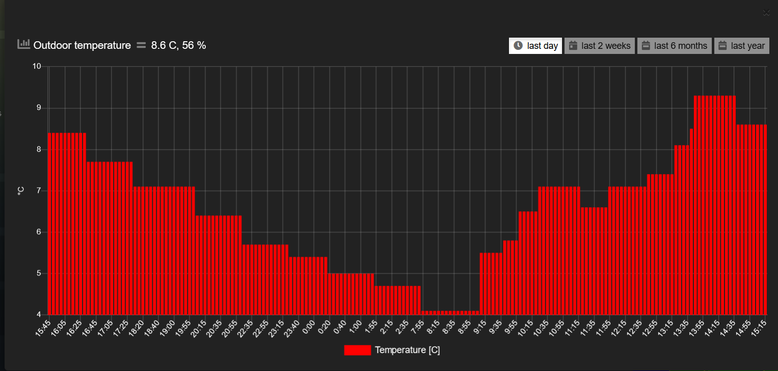

I was playing with the graphs in dashticz. But I noticed the graph in both Dashticz and Domoticz have a very staircase look.
I dug into this and noticed there are datapoints every 5 minutes. But since the sensors send an update much less frequently, there are a lot of consecutive datapoints with the same value. And this is causing the staircase look.
Below I attached a screenshot. I changed the graph type to barchart to show explicitely how many datapoints there are in the graph. Each red line is a datapoint in the table. But the number of measurements coming from the temperature sensor are actually much less.

Normally these kind of Zigbee sensors only send data if the delta reaches a treshold e.g. 1 degree. This to minimize battery consumption.I think Domoticz is registering sensor values every 5 minutes. If no new data is received it wil register the old value (as nothing has changed).

Thanks for the explanation. That sounds indeed as what I am observing. The step change is constant, and the timeperiod between measurements is varying.
The source of my question was that I would like my graph a bit nicer and smoother looking line graph. But the 5 minute duplication of the values gets in the way. They cause the staircase effect.
Any suggestion to get around this?
