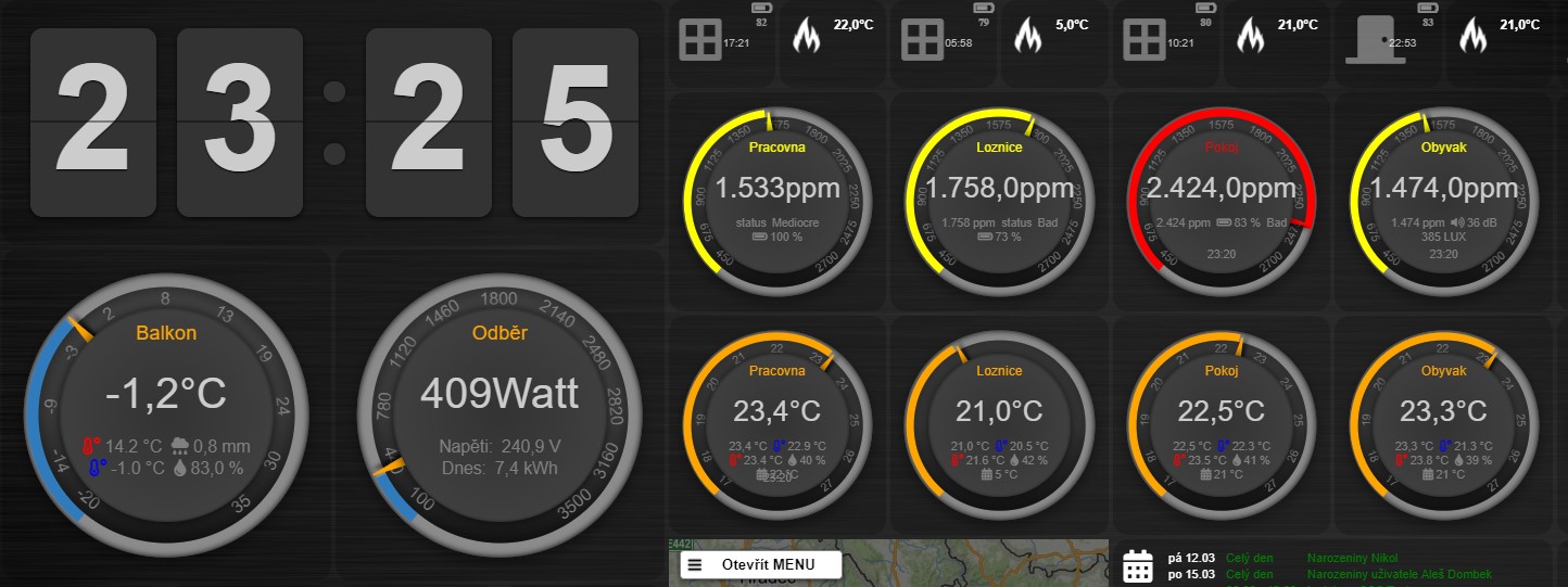

Re: Dashticz v3.7.6 beta
Posted: Friday 12 March 2021 23:26
by Krenstik
I remove it, as is not nessesary and is fine ;-)
NOw I have to clean values, to have not a double value.
Snímek obrazovky 2021-03-12 232553.jpg (161.91 KiB) Viewed 4818 times
Posted: Friday 12 March 2021 23:39
by Lokonli
I made some small styling changes. Please pull latest beta version. (the unit behind the main value will become a bit smaller)

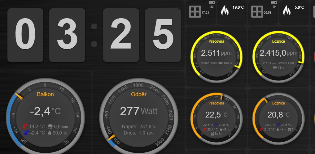

two questions:
How I can get two (three) lines on dial? Always two lines? Like in dial "odber /409 Watt" In the case of the dial " Pracovna" with CO2 (ppm), if the text is shorter, It mixes it two status.
Can I add spares between value and unit in dial " Odber"? (277Watt)
Thank you.
Posted: Saturday 13 March 2021 9:06
by Lokonli
Krenstik wrote: Saturday 13 March 2021 3:32
Add the following to the item definition in the values part, to give the item the full width:
  addClass: 'w100'
I've increased the left margin of the unit a little bit in latest beta. Sufficient?

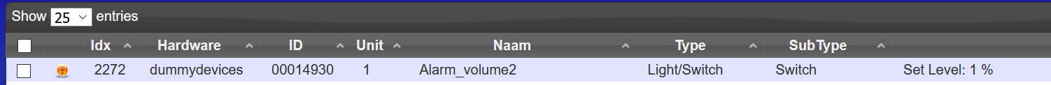

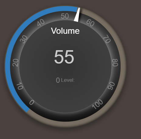

I got a little issue.
I use a dimmer switch to manage the volume of my alarm (devices), off, on with volume x-y.
I made a dial for this switch.
When i turn the volume to 0 (i use zero for off) then domoticz gives a value 1 (so not off in my case)

pvklink wrote: Monday 15 March 2021 18:33 I got a little issue.
blocks['volume']	= {
	title: 'Volume',
	idx:	2272,
	values:	[
		idx: 2272,
		decimals: 0,
		setpoint: 60,
		isSetpoint: true
	layout: 1,
	type: 'dial',
        color: 'white',
	width: 3,
//	icon: '',
	hide_data: false,
	switch: false,
        min: 0,
        max: 100,
        showring: true,
        showunit: true,
	decimals: 0,
	animation: true,
//	fixed: true,
        shownumbers: true,
        last_update: true}
Should work better now. Can you test latest beta?

by pvklink
lokonli is great... :-)
Problem solved and you also solved a problem i wanted to adress after this:
- when you change a value in domoticz, this dashticz dial does not refresh, this also solved :-)
for me last questions are:
0. how do i get rid of "0 level" in the dial , see attachment.
hide_data: true, does not help
@update: solved, by removing the values part and add isSetpoint: true in the main part of the block
1. what does "fixed" do?
2. In my case do i have to repeat idx 2272 in the main part as well as in the values part
@update: solved, values part removed
3. Does setpoint: 60 has any use ? i thougt you could influence the colors of the ring when below or above this point
4. what does layout do
