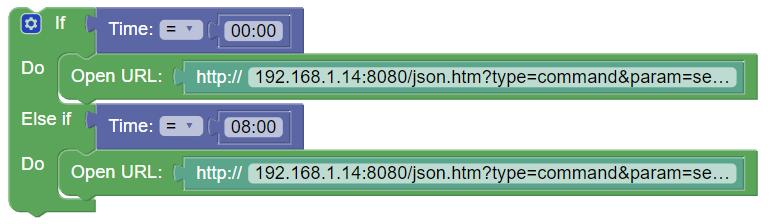

Re: Disable Switch use certain times of day?
Pauldc wrote: Tuesday 09 March 2021 13:58 Seems I'm not even sure where to start I haven't been able to set a blocky script for this i was thinking something like this but never used json before
Can you try this ?
Blockly 20210309 Disable device.png (33.81 KiB) Viewed 2123 times
You can import below xml in the event editor (use the +, Blockly, import button, paste below code and save as time triggered)
<xml xmlns="http://www.w3.org/1999/xhtml"><block type="domoticzcontrols_ifelseif" id="yaJ1v4J{D{d5qvKaWL5M" x="13" y="14"><mutation elseif="1"></mutation><value name="IF0"><block type="logic_timeofday" id="P}IqP(8(ZGLRRSX*jXF$"><field name="OP">EQ</field><value name="Time"><block type="logic_timevalue" id="=k#353ET?9+gn~W=NnxE"><field name="TEXT">00:00</field></block></value></block></value><statement name="DO0"><block type="open_url" id="U=u((isL{0TE)ZVzZga="><value name="urlToOpen"><block type="url_text" id="w,mie_uNr!J*_Z.k_|K9"><field name="TEXT">192.168.1.14:8080/json.htm?type=command&amp;param=setdevused&amp;idx=2651&amp;used=false</field></block></value></block></statement><value name="IF1"><block type="logic_timeofday" id="!=/s@}gG86^sJwoedFI:"><field name="OP">EQ</field><value name="Time"><block type="logic_timevalue" id="J@.|QA?wjQJ;CH0sDCYF"><field name="TEXT">08:00</field></block></value></block></value><statement name="DO1"><block type="open_url" id="T;d`?$~(~,|?EaEt{U`s"><value name="urlToOpen"><block type="url_text" id="l1avg@Tohkn$V#fzM%kQ"><field name="TEXT">192.168.1.14:8080/json.htm?type=command&amp;param=setdevused&amp;idx=2651&amp;used=true</field></block></value></block></statement></block></xml>

Ok yep imported it and have tried it by changing times just so I can test it, but seems if I goto switches and click the switch with that IDX it turns on as normal, anything I'm missing that you can think of?
once again thanks for taking your time to help me
waaren wrote: Tuesday 09 March 2021 15:48
Can you try this ?
Posts: 6676
Domoticz version: 2025.1
You perhaps will have to refresh the switches page to see the device disappear if disabled.
To test de link: If you copy past the url in a webbrowser it will also enable/disable the device, does it work?
