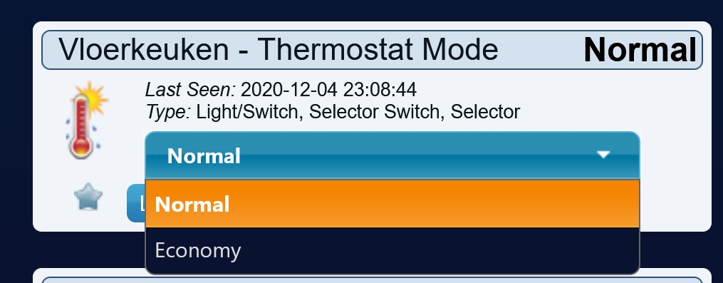

Is it possible to change the setting of the thermostat setting in blockly? lets say if switch "121" is on then set this to economy and if switch "121" is off then to normal again.
If someone can give me a push how to get it done :D
