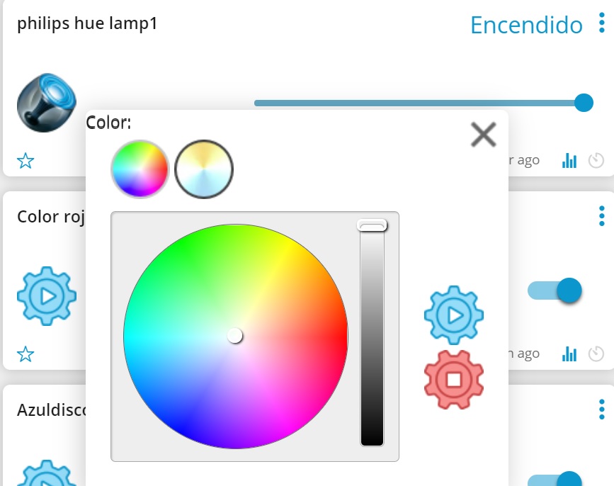

Yes, I have a group created in zigbe2mqtt, and I act through scripts on the 4 bulbs at the same time making a call to the group. But from domoticz I cannot act on 4 at the same time using the color circle (color palette) of the domoticz device. I attach a photo.waltervl wrote: Thursday 18 February 2021 19:34 Create a group in zigbee2mqtt and name it according the rules to get a dimmer. See also https://github.com/stas-demydiuk/domoti ... qtt-plugin
thanks in advanced
Best regards

You should ask.the plugin maker. Can you change to color from Zigbee2mqtt directly?
What do you see in the logging of Domoticz if you try to change the color from Domoticz?
