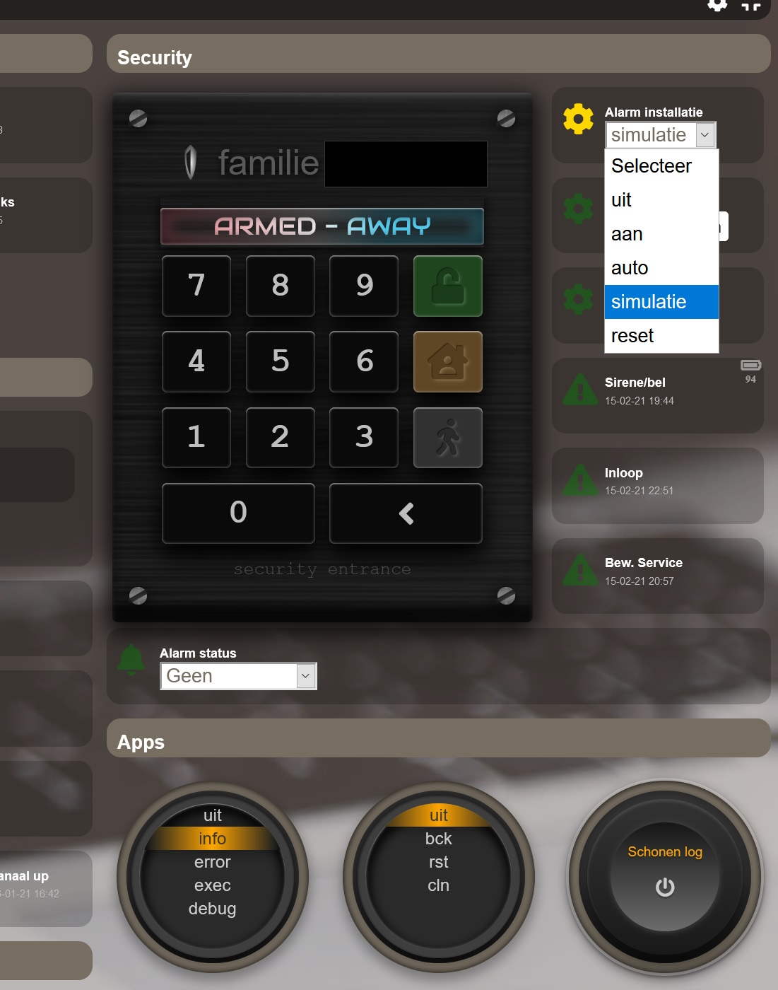

For those who want to use a alarmscript with in out delay, the next script works for me, with thanks to waaren.
Below in the script you can add simular sensor groups like smoke. doorsensors etc.
For each sensortype you only need two lines of code, the rest can be changed by variables...
I need to add some sensortypes myself and add some messages for debugmode and change delaytimers for variables...
Small part of my dashboard
Alarm: off, on, simulate, auto
Setting alarm: bel, siren
Check delay
Check alarmtypes
Setting motion service
(on next page: 40 sensors, two cams etc.)
