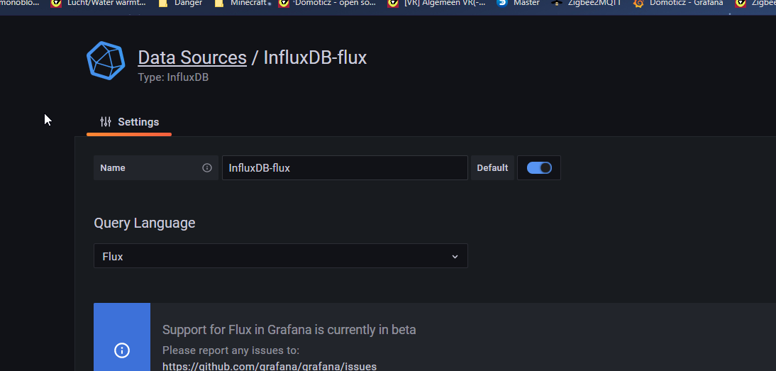

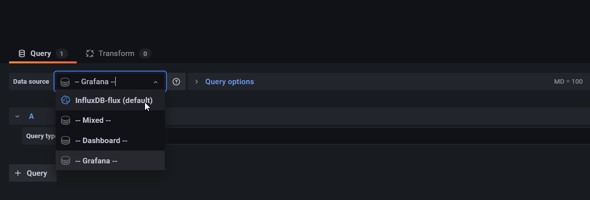

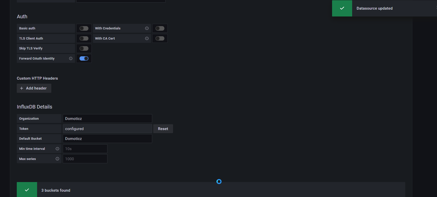

Perhaps some one have a aexample query form the bucket?
I do not get an error in domoticz, log, so i think i upload to the bucket.
Only i cannot set the bucket the good way to get data visiable..

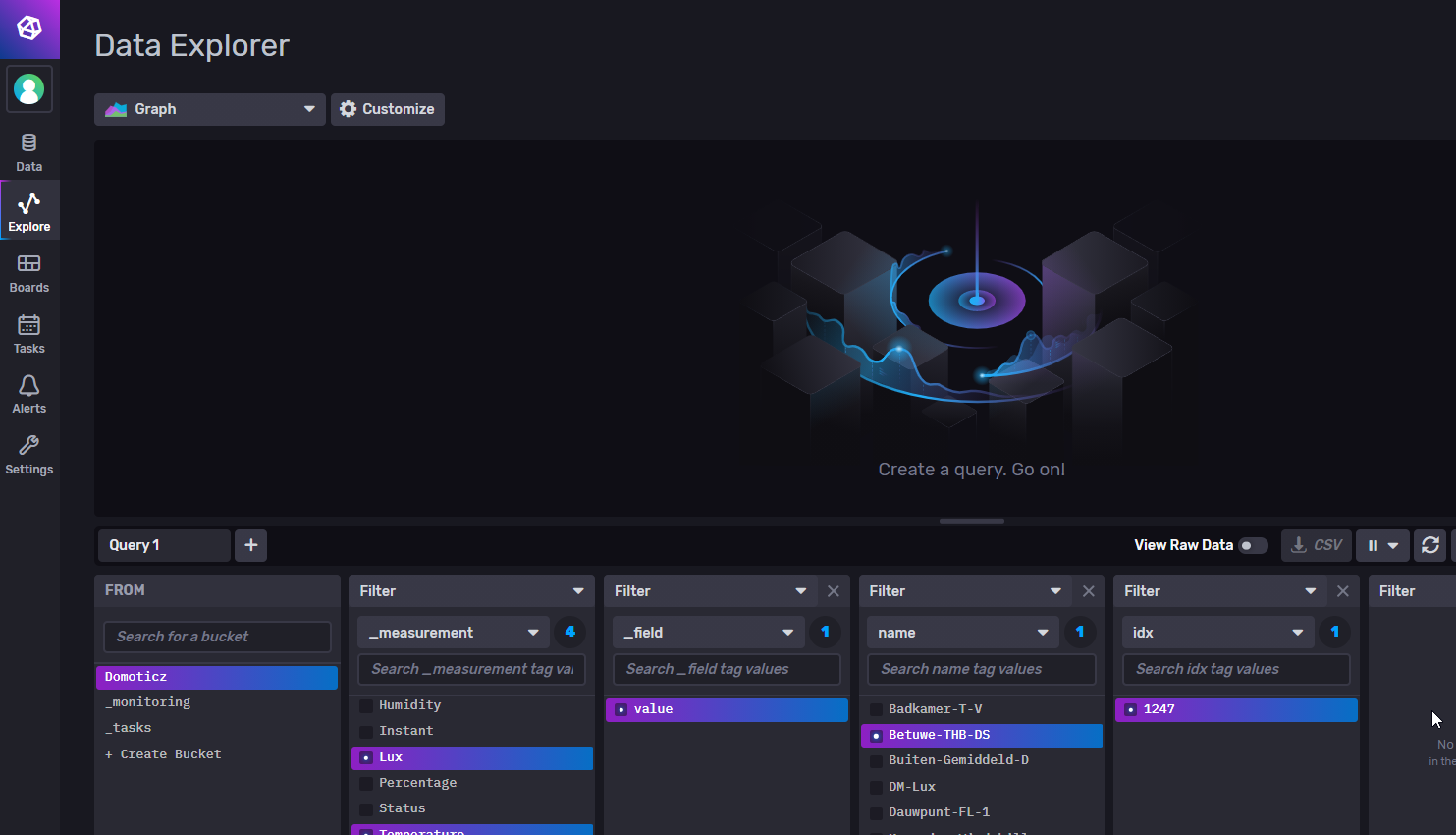

Derik
Posts: 1605
Re: Possible problem with sending data to Influx
Post by Derik »
And when i look into flux there a idx and a lot of data
