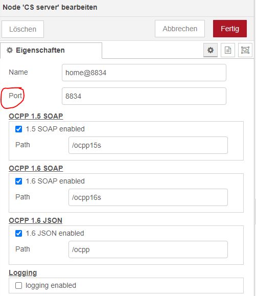

Sure thing. This applies to a Schneider G4 22KW Box:
All you need to do is to enter the supervision URL in the supervison settings tab. Please note that -at least in my case- the tab will only be visible after setting the box to 'supervised'
the URL is build of:
ws://IP_ADRESS_OF_NODE_RED_INSTANCE:PORT/OCPP
in NR you set the CS Server node according to the screenshot (same port).
if all goes well, you should start to receive hearbeat messages in NR.
