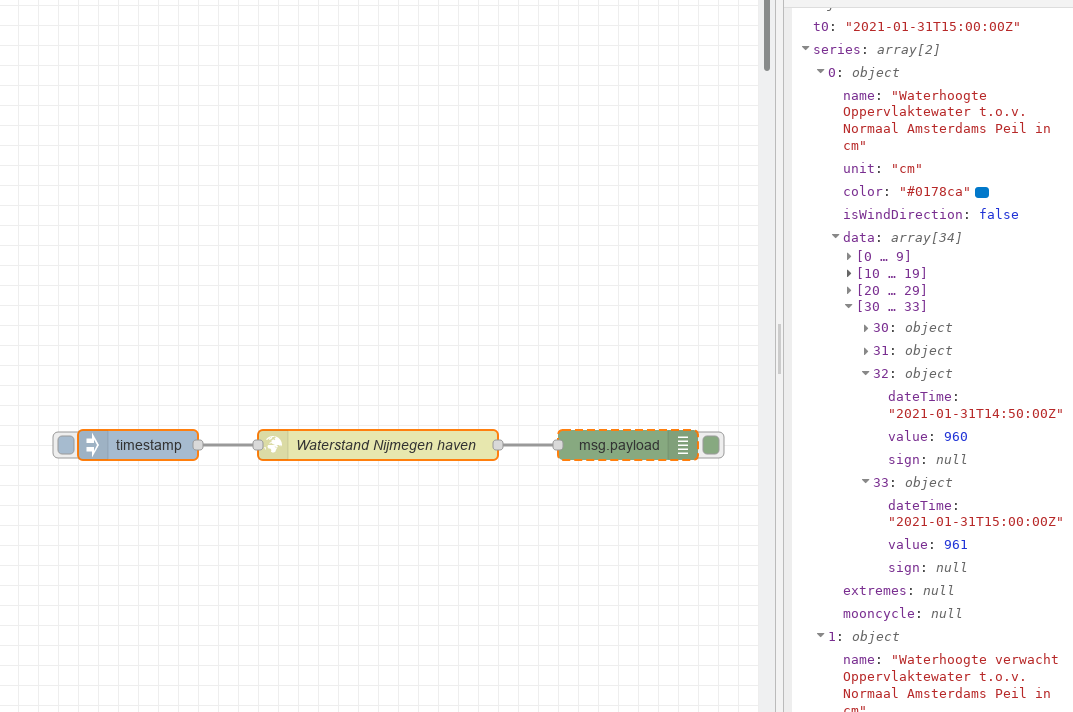

Hello @Jan Jansen,
Good afternoon Jan,
Is it possible to display the water level of the Nijmegen haven measuring point in Domoticz?
Yes, that is possible.
If you inspect the map, displayed at: https://waterinfo.rws.nl/#!/kaart/waterhoogte/ and click on the desired measuring point, you will move on to the details. As an example we will use the measuring point "Nijmegen haven". (click on it and go to More details)
By default you will get all data from 2 days back to 2 days ahead. You can change that to 6 hours back to 3 hours ahead. Also 2 other time windows are possible, but not interesting for now.
If you use the following URL: https://waterinfo.rws.nl/api/chart?mapT ... alues=-6,3,
you will get a JSON response with the required data for that location.
Keep in mind that the time is noted in UTC (Zulu time zone) and that the data is updated every 10 minutes.
You have used Node Red before and if you insert that URL in a http request node, you will get the following:
The last data measured is always in the last object of the array. Currently, as you can see, the water height is 961 cm, measured at 16:00 h CET.
After that array you will get the predictions.
If you need some support in pushing it to a Domoticz virtual sensor, let me know.
Best regards

Hello @waaren
I have to confess, that I have seen that as well, if I use Chrome.
You can normally browse with Chrome to that page, but if you try to inspect that page, you will see an error.
DevTools failed to load SourceMap: Could not load content for https://waterinfo.rws.nl/scripts/ol.js.map: HTTP error: status code 404, net::ERR_HTTP_RESPONSE_CODE_FAILURE
and also
Error: Unexpected end of JSON input
I found the URL with the Inspector of Firefox. In Firefox it functions. However if I open in Firefox another tab and I copy the URL to that tab I also see XML code. No idea why.
I inserted the URL in the http request node of Node Red and it works fine. See the picture.
I'm sure that there is something in the webpage, but I do not see, what it is.

Hello @Jan Jansen,
As @waaren already said, it is up to you whether you choose the solution with dzVents, which is quite compact, or if you choose to implement the solution with Node Red.
As @waaren already presented his solution, I cannot stay behind.
Please find below the Node Red solution.
Screenshot_Waterstand Nijmegen_haven.png (20.83 KiB) Viewed 4249 times
Flow:
[{"id":"f1324d44.f6688","type":"tab","label":"Waterstanden","disabled":false,"info":""},{"id":"c0e85807.57038","type":"http request","z":"f1324d44.f6688","name":"Waterstand Nijmegen haven","method":"GET","ret":"obj","paytoqs":"ignore","url":"https://waterinfo.rws.nl/api/chart?mapType=waterhoogte&locationCode=Nijmegen-haven(NIJM)&values=-6,3","tls":"","persist":false,"proxy":"","authType":"","x":460,"y":140,"wires":[["85ee7f6b.fcb8e"]]},{"id":"bb820068.b3cc58","type":"inject","z":"f1324d44.f6688","name":"10 Minute Inject","props":[{"p":"payload"}],"repeat":"600","crontab":"","once":true,"onceDelay":0.1,"topic":"","payload":"","payloadType":"date","x":190,"y":140,"wires":[["c0e85807.57038"]]},{"id":"a54daffb.02255","type":"function","z":"f1324d44.f6688","name":"","func":"var time = msg.payload.t0;\nvar height = msg.payload.series[0].data[msg.payload.series[0].data.length - 1].value;\nmsg.payload = {\"command\":\"udevice\", \"idx\":11, \"svalue\":\"Meettijdstip: \" + time +\"\\n\" + \"Waterstand: \" + height + \" cm\"};\nreturn msg;","outputs":1,"noerr":0,"initialize":"","finalize":"","x":960,"y":140,"wires":[["995c142.98c27e8","90315b4d.41f05"]]},{"id":"995c142.98c27e8","type":"debug","z":"f1324d44.f6688","name":"","active":true,"tosidebar":true,"console":false,"tostatus":false,"complete":"false","statusVal":"","statusType":"auto","x":1150,"y":200,"wires":[]},{"id":"85ee7f6b.fcb8e","type":"moment","z":"f1324d44.f6688","name":"","topic":"","input":"payload.t0","inputType":"msg","inTz":"ETC/UTC","adjAmount":0,"adjType":"days","adjDir":"add","format":"DD-MM-YYYY/HH:mm:ss","locale":"nl-NL","output":"payload.t0","outputType":"msg","outTz":"Europe/Amsterdam","x":740,"y":140,"wires":[["a54daffb.02255"]]},{"id":"90315b4d.41f05","type":"mqtt out","z":"f1324d44.f6688","name":"To Domoticz","topic":"domoticz/in","qos":"","retain":"","broker":"f9f13036.e28b58","x":1150,"y":140,"wires":[]},{"id":"f9f13036.e28b58","type":"mqtt-broker","name":"localhost","broker":"127.0.0.1","port":"1883","clientid":"","usetls":false,"compatmode":true,"keepalive":"60","cleansession":true,"birthTopic":"","birthQos":"0","birthRetain":"false","birthPayload":"","closeTopic":"","closeQos":"0","closePayload":"","willTopic":"","willQos":"0","willPayload":""}]
As I have chosen to put the data in a "Text" sensor, you will see the following result:
If you want another sensor, I can adapt the flow, quite easily.
Do not forget to change the IDX number (currently 11).
Best regards

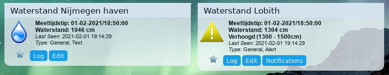

I published (a part of) the available data to a "Text" sensor. As users may want to see a little bit more, I extended the flow with some extra (dynamic) information, which is published to an "Alert" sensor.
See the example below and compared with the previous sensor:
The limits (in this example for "Verhoogd" (1300 -1500)) depends on the measuring location.
The modified "Function" node looks as follow:

What ever you may prefer, a "Text" sensor or an "Alert" sensor, that goes from "Low water" (grey) to "Extreme high water" (red).

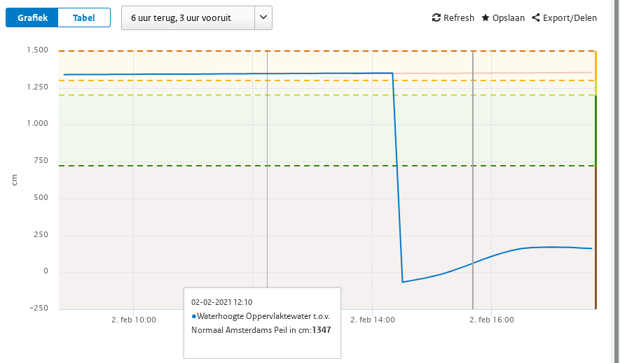

I started this small project, because of the question from Jan Jansen.
Although the scripts are functioning quite right, I noticed some inaccuracy of the data provided by Rijkswaterstaat.
For example the water height at Lobith went even negative and dropped from over 13 m to approx 1.5 m. I'm sure that this was not correct.
See the graph below.
I do not notice that in the graph of 2 days back and 2 days forward.
To check, I have updated my URL from -6,3 to -48,48 at the end. (I will report back)
