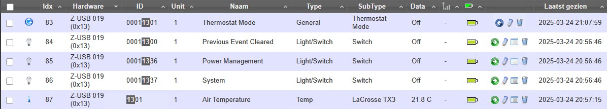

Is there also already an update for the newer 4.9 firmware?
When I try to add the Fibaro heat controller to Domoticz I'm not able to control anything...
The devices appears as follows:
The hardware appears as follows:
So no setpoints are appearing as stated in: https://www.hellosmarthome.nl/post/revi ... /domoticz/
Is there anyone who can help me with this issue, or is the newest firmware version of the FGT-001 simply not compatible with Domoticz?

Are you using zwavejs-ui ? And are you on the latest Domoticz beta version?
Bakel04
- Posts: 2
- Joined: Monday 24 March 2025 20:50
- Target OS: Windows
Re: Fibaro Heat Controller newer firmware
I'm indeed using the latest Domoticz Beta version.
And I'm not using zwavejs-ui (yet
Can the zwavejs-ui solve my issue?
