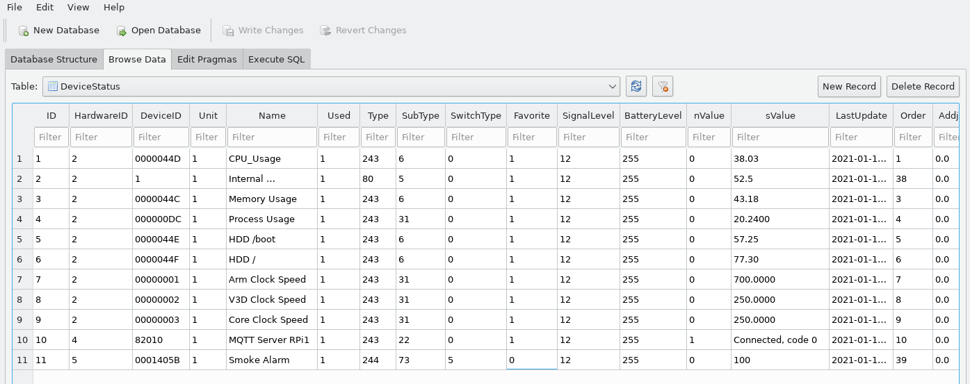

But how many will understand what the sequence "11|5|244|73|100|0" means? And, if I understand, how can I correctly control this Smoke Detector?
Use of the DB Browser for SQlite gives the same result (see the last line):
The solution that comes closest to the goal is the third possibility, offered by @waaren.

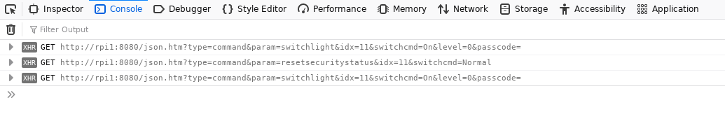

Clicking the smokedetector on the device tab while opened the developer console on the network tab of your browser will show you the JSON for activating the detector
I have not been able to find the right command in the "network" tab. I have tested it with Google Chrome and Mozilla Firefox under Linux.
I finally found it under the "Console" tab and "Requests" tab.
In addition to what @waaren wrote you can also use the passcode (of that switch). I assume you need it, if the switch has been set to protected.
I think that is recommended for a Smoke Alarm.
You will also have noticed that there is a "level΅.
What does that level represent? I think that is one of the questions @grumpy wants to know, if you want to control this switch with a remote command.
