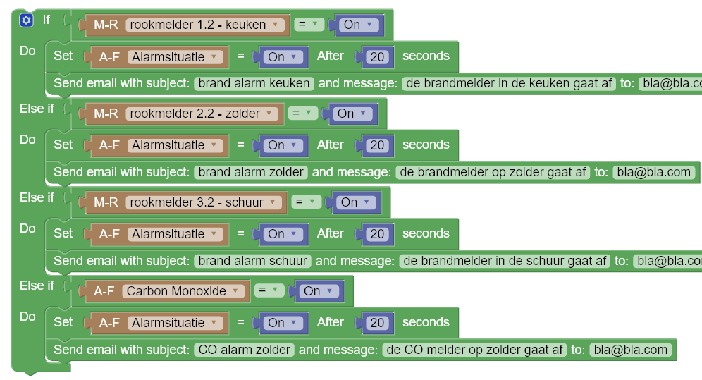

I am messing around with zwave smoke detectors and I'm trying to catch false triggers. I don't know why but every once in a while these devices fail to report in time I guess and this would then falsely trigger the alarm. But firing a trigger and then do the check feels wrong.
Blocky does allow for .setOnAfter(20 sec) apparently... and so:
With this you can differentiate between email txt's. ..the roof, the roof is on fire!!.. ;)
This solution also works for door-contact/burglar alarms, in the case of kicking the annoying cat out the door in the middle of the night.
