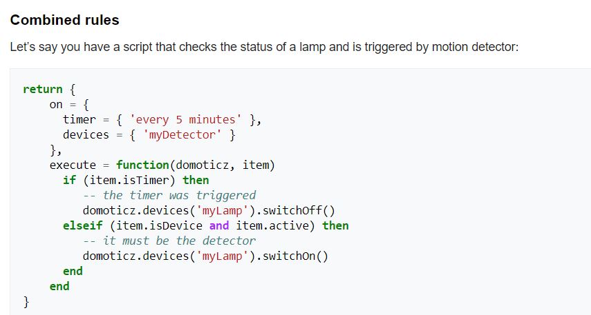

Looking to this example, I understand that I can trigger a function by timer OR device
I want always turn off display and, only from 22:00 to 8:00,set to Quiet mode, so I developed this code, but is not working as I supposed:

Does the script have to run every minute or only on a device update or both?
If you want to check a time hen it is easier to use something like
if dz.time.matchesRule('at 22:00-08:00') then
in the execute body of the script.
elseif (AC_Quarto.isDevice and AC_Quarto.active) then
Should probably be
elseif item.isDevice and AC_Quarto.active then

If you want this only to happen when the script is triggered by a time- or a device-trigger then change the function walkConditions to
        local function walkConditions(type, active)
            if item.isTimer or item.isDevice then
                for _, control in ipairs(controls) do
                    if control[type] and control.active == active then --type is a variable key in the table and control.active is a string key
                        for _, postData in ipairs(control.post) do
                            post(postData)

I want walkConditions triggered only by device state and get the temperature or device switch status every 3 minutes
If I include item.isTimer in walkConditions, function will execute also every 3 minutes. May be just enough with item.isDevice.
