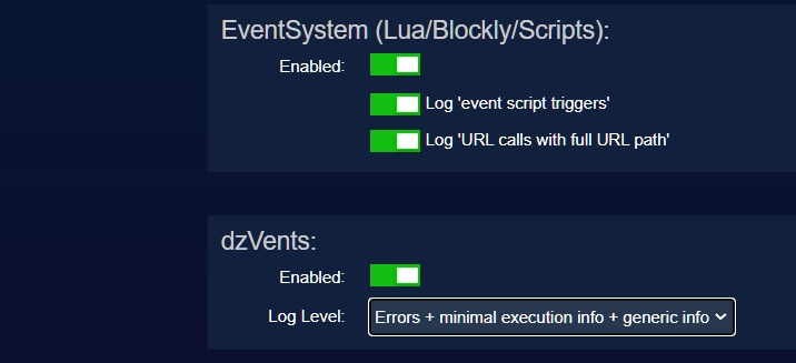

iganin wrote: Monday 07 December 2020 9:36 I have set domoticz.LOG_DEBUG in the script and "error only" in the Domoticz settings. However, I see no logs.
Can you try again after setting the loglevel for dzVents like below?
log settings.png (24.58 KiB) Viewed 1192 times

Now I see all logs from all scripts.
Odd, the one mentioned above shows without the marker
2020-12-07 10:05:38.757 Status: dzVents: Info: Handling events for: "Bathroom 2nd Floor Door Sensor", value: "Open"

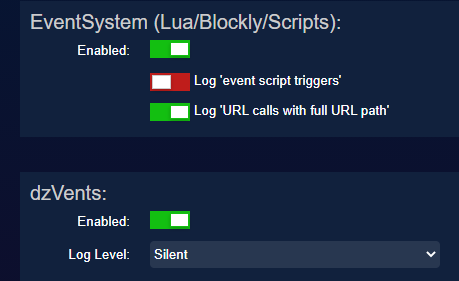

The marker should be in the message. Can you share the complete script?
To prevent all other dzVents scripts from sending something to the log:
You can set the EventSystem and dzVents settings to
and set logging = { level = domoticz.LOG_ERROR }, -- in the logging section for all scripts
and use dz.log('your message ', dz.LOG_FORCE ) -- for all messages in the script you do want to investigate
