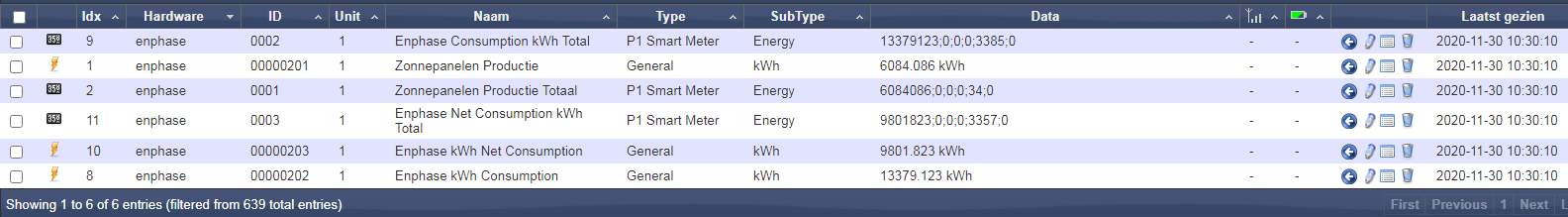

i have enphase info in domoticz from the envoy api. you could check on the Enphase kWh Production device. if it's >0 it is producing energy. i get that from the enphase plugin. i also run a script to get info from all the individual inverters, but that is probably not useful for what you want to accomplish.
i'm no good at scripting myself, others are probably much better equiped to help you there. with blockly you could probably do it like this
Untitled 2.png (127.46 KiB) Viewed 1057 times
and add a shutoff too.
