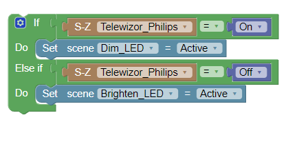

I try to release the dimming by the TV, but, despite the TV state is discovered well (the log says the tv is on or off), I can't make the dimmer work with that.
I tried a blockly scheme without success.

And do you know why the blockly scheme did not work?

Did you store the Blockly as being device triggered?
Do you see anything in the domoticz log when changing the state of the virtual switch?
