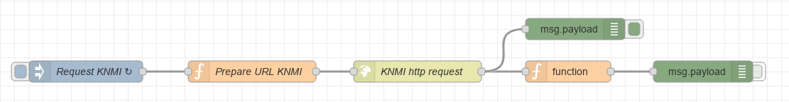

I really have no idea, what you are doing, but your flow should look like:
After the HTTP request node, you can connect a Debug node (the one just over the function node).
If I press the "Inject" node you will get the items, you mentioned in your previous post.
Among them "verw:"
If you move your mouse over the light grey area, you will get 3 more icons.
If you click on the most left one (>_) the path is copied to the clipboard. (The middle one copies the value, while the right one pins the item).
The contents of the Function node (function) is as follows:
msg.payload = {"command":"udevice","idx":111,"nvalue":0,"svalue":msg.payload.liveweer[0].verw};
return msg;
After that, if you press the Inject node , you will see at the other Debug node the result, as shown in my previous post.
