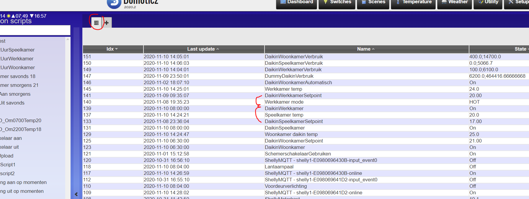

2) Go to Setup --> More Options --> Events.
3) You'll see something like this: 4) Take note of the device names or "state" there
5) Create a new script with the + icon, en choose dzvents there.
6) doesn't matetr which template you'll select, just delete everything to start an empty script.

1) So you already added the daikin to domoticz with the plugin, thats step 1.
7) Create a script
