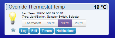

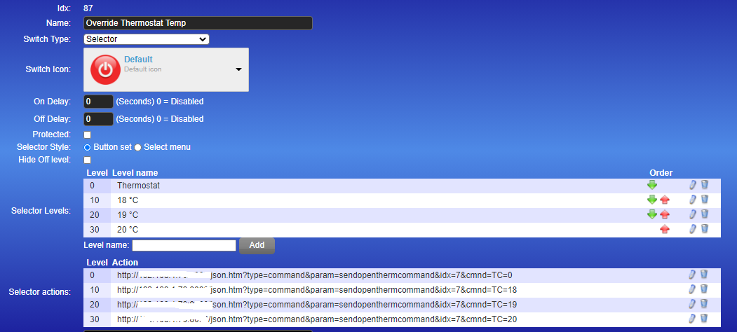

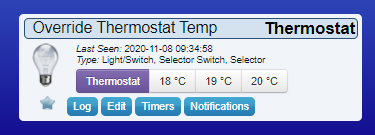

Update: I found a solution using a selector switch (virtual sensor) without having to script, allowing me to set some predefined override temperatures to the thermostat and also remove the override giving the control back to the thermostat. Works perfectly fine...

Problem: I am trying (for more then a year (off and on) to send a command to OTGW to control my OTGW-module (and boiler). Your post came as nearby as possible, but it didn't work with me. I do something wrong, but what?
I foudn( from earlier posts) that when i send "http://192.168.178.10:8080/json.htm?typ ... d=CS=44"in a normal browser (for me Firefox), there comes an OK and in Domoticz/ log there will be a positive answer (like: 2020-11-29 01:05:09.108 Status: User: pi initiated a manual command: CS=44 ; 2020-11-29 01:05:09.226 Status: OTGW: CS: 44.00.
But when i place the same sentence in a dummy switch or the selector-switch you used (a much better choice) (or in Blockly-URL), i get in the Domoticz/log an error : Error: Error opening url: http://192.168.178.10:8080/json.htm?typ ... cmnd=CS=44.
I think taht i used the wrong URL. The URL 192.168.178.10 is the url for my Pi and 8080 the port to Domoticz. I tried also the url for teh OTGW-module: also no succes. The idx=6 is the idx in the Hardware-part for OTGW.
PLEASE: what do i wrong? I think it is a little fault, but essential!! and what is the good approach?? I hope you can help me. I am beginning to be a litlle (or much more) desperate.

Do try 127.0.0.1:8080 as the url
Help needed using "OpenTherm Gateway with LAN interface Version: 6.2"
1) What is IDX 7 in the CaptainSlow example? Why do you need it, is it some kind of return value?
2) which IP adres to use? The domoticz or the OTGW address?
3) what port to use? 8080 (domoticz) or the port number in the hardware section 25238?
UPDATE: AH, IDX is the IDX number of the OTGW device in the hardware section (first column)
found it using F12 console in web browser when sending commands

http://192.168.178.10:8080/json.htm?type=command¶m=sendopenthermcommand&idx=6&cmnd=TC=20 See for an example how to send internal api commands through dzvents:

Until now I tried to use the idx of my OTGW "room setpoint" device and I did not get it working.
Now I understand it should be the idx of the OTGW USB device as listed in the "settings/hardware" tab. It finally works, thanks a lot!!!!
The IP address I use is 127.0.0.1 and the port number is 8080 (which is the default domoticz port number), so 127.0.0.1:8080
