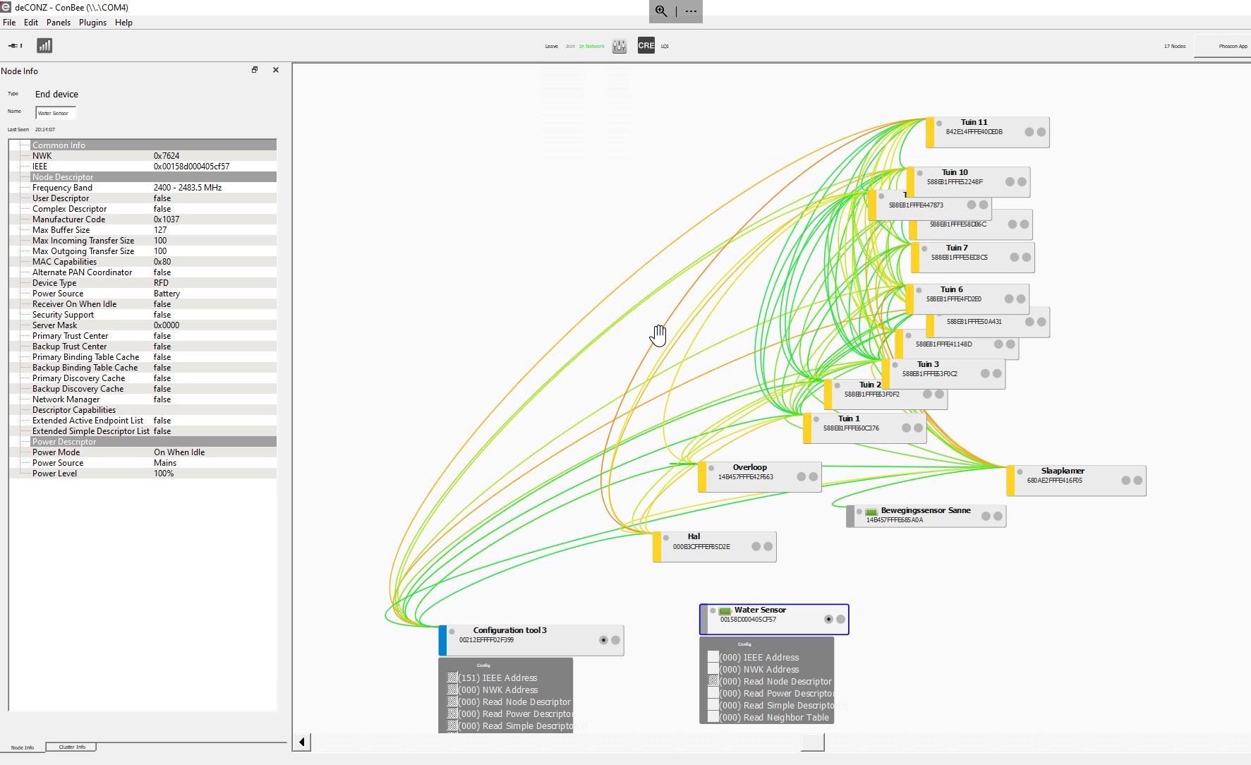

Re: deConz not ready
This is what my deCONZ currently looks like.

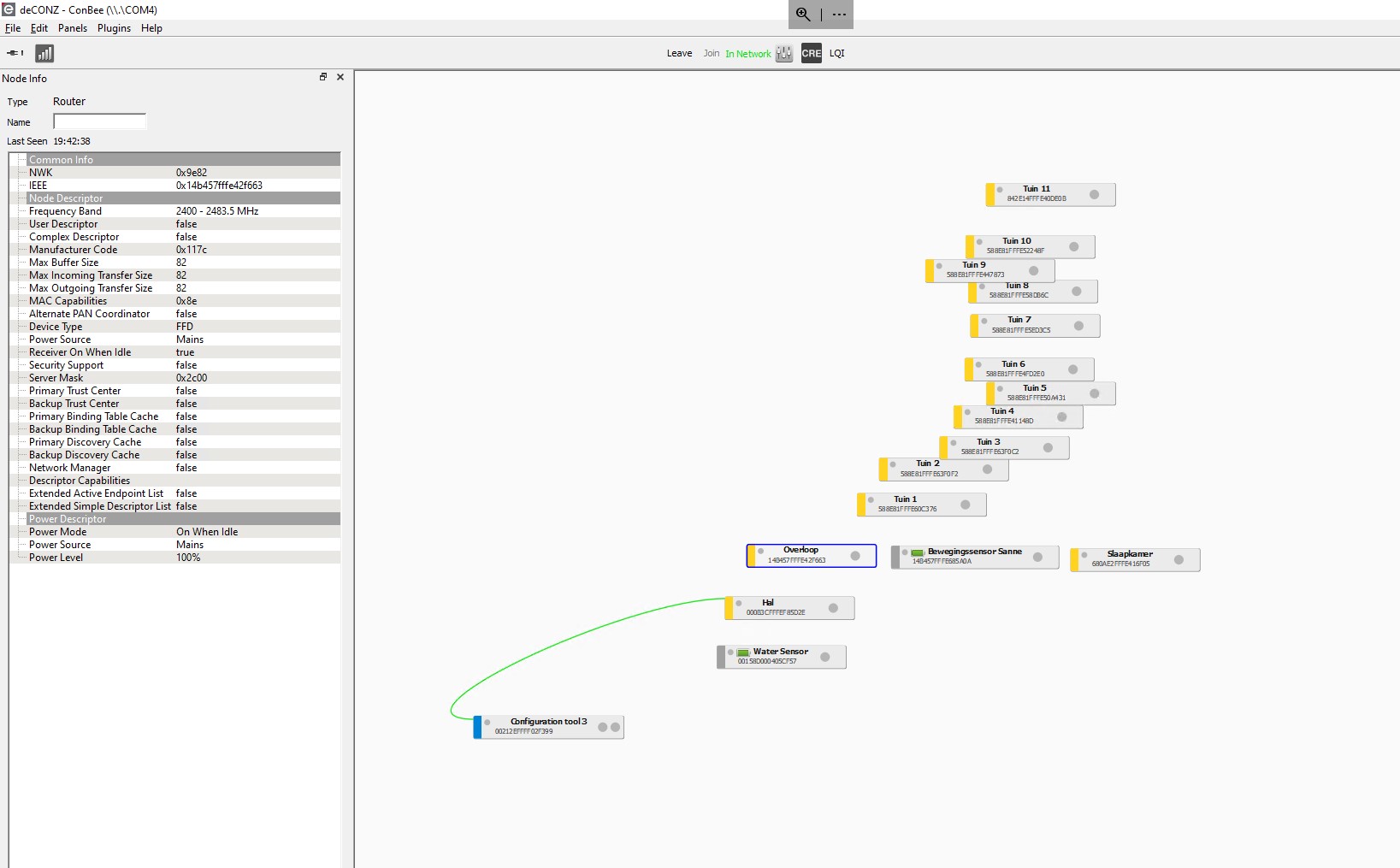

This is what it looks like now.

In the deCONZ application everything is connected to the host. In order to achieve that I did have to use an USB extension cable, which I didn't really want to. But I think it is too close to the Z-Wave USB stick otherwise.
Thanks again for thinking along!
