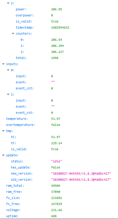

I'm trying to extract some data from a shelly 2.5 device
The script executing leaves me with some questions.

I checked for 2 devices, one with power consumption of 4.26 Watt and the other with power consumption 206.95 Watt

This 206.95 cannot be fetched whilst the Voltage 231.66 is displayed without a problem.

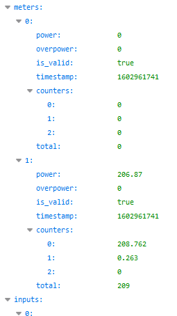

Then there is this other question on how to fetch data from unit [0] (part of script)
domoticz.devices('Shell').updateCustomSensor(item.json.meters[0].power)
      -- Shelly-test.lua:22: attempt to index a nil value (field '?')

HvdW wrote: Saturday 17 October 2020 19:15 I'm trying to extract some data from a shelly 2.5 device
I you insert below line you will get the complete table as it is translated by dzVents from the JSON return. That might help in identify the issue(s)
domoticz.utils.dumpTable(item.json)
directly after the line
if (item.ok and item.isJSON) then

It simply skips Power because
Meters: 0: Power: is translated to domoticz.devices('Shell').updateCustomSensor(item.json.meters[1].power)
and
Meters: 1: Power is translated to domoticz.devices('Shell').updateCustomSensor(item.json.meters[2].power)
Which of course explains why domoticz.devices('Shell').updateCustomSensor(item.json.meters[0].power) delivers
The reason why this 4.26 Watt device responded is because that one has both lights connected, so
does indeed return a value.
Thanks @waaren for the
suggestion.
Bugs bug me.
