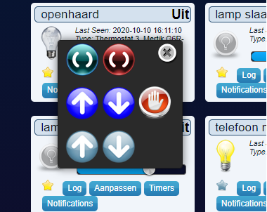

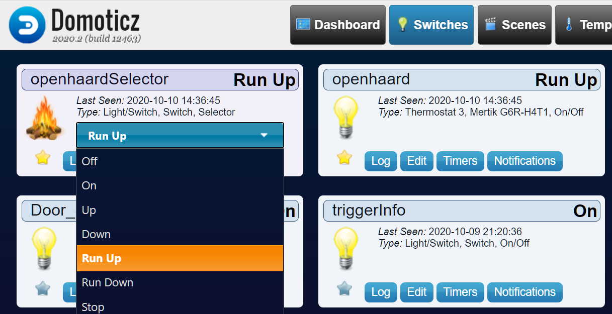

i have the mertik heard controller and i can send commands with the domoticz ui
i can turn it on/ off and control the valve
with the dzvent i can only sent the on and off command
i have checkt that when i send a comand the value chance for 0 to 6 with each it function
i can
do somone now how i can send the right command for the valve

goldman541 wrote: Friday 09 October 2020 1:16 Do someone know how I can send the right command for the valve?
Can you show the device as it is on the device tab and as it is on the switch tab?
How do you control the valve with the GUI?
When you click on the light bulb then comes a popup with 7 options you can choose to operate the valve
Verstuurd vanaf mijn SM-G950F met Tapatalk

i see a differents by the nvalue
Re: Mertik G6R-H4T1 controling with dzvents
goldman541 wrote: Friday 09 October 2020 17:52 i see a differents by the nvalue
Thx. Will have a look but could take some time.
goldman541 wrote: Friday 09 October 2020 17:52 I see a differents by the nvalue
Yes. The nValue is controlling the status of this deviceType.
I will have a look to implement a device-adapter in dzVents for this device and also to see if it can be made possible to change the icon but don't expect that soon. For now I prepared the attached dzVents script that will set the nValue of the device based on the level of a selector switch. Of course you can use the setValues method also in another way
return
    on =
        devices =
            'openhaardSelector',
    logging =
        level = domoticz.LOG_DEBUG,
        marker = 'openhaard',
    execute = function(dz, item)
        local openhaard = dz.devices('openhaard')
        dz.log('Selector ' .. item.name .. ' set to ' .. item.levelName, dz.LOG_DEBUG)
        openhaard.setValues( item.level / 10 ) -- setting the nValue of the openhaard device to 0,1,2,3,4,5 or 6 depening om the selector

waaren wrote: Saturday 10 October 2020 15:13 Yes. The nValue is controlling the status of this deviceType.
it change the mode for the openhaard but it does not send the command
it only send a command when i do it with the popup

Re: Mertik G6R-H4T1 controling with dzvents  [Solved]
goldman541 wrote: Saturday 10 October 2020 19:32 that works also
Thx.
Until the device adapter is integrated in domoticz Beta you can use something like below. (see for the selector one of the previous posts)
return
    on =
        devices =
    logging =
        local openHaard = dz.devices('openhaard')
        local function setValve(id, action)
            local action = action or 'Off'
            action = action:gsub(' ','%%20')
            local url = dz.settings['Domoticz url'] .. '/json.htm?type=command&param=switchlight&idx=' ..id  ..'&switchcmd=' .. action
            dz.openURL(url)
        if item.nValue == 0 and openHaard.nValue ~= 0 then
            setValve(openHaard.id)
            dz.log('Selector ' .. item.name .. ' switched Off', dz.LOG_DEBUG)
        elseif item.nValue * 10 ~= item.level then
            setValve(openHaard.id, item.levelName)
            dz.log('openHaard valve is already in state ' .. item.levelName, dz.LOG_DEBUG)

it's working now thank you
