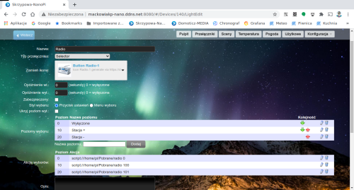

I use virtual selector switch to turn on/off, channel up/down of radio receiver. My goal is to move appropriate commands from sensor definition to LUA script.
Below current definition of "Radio" sensor:
The LUA script as shown below, does not work. Of course in case of using LUA, actions definitions from sensor definition are removed.

The lua script does not see the custom field names but sees the selector switch as level %
0 = off
10= first choice
20=second choice
start with : print(otherdevices[sensor])
Look in the log after switching and you will understand
once you have seen it then it is easy :)
so you will need something like
if (devicechanged[sensor] == 'Off') then
do somehing
else if (devicechanged[sensor] == 'Set Level 10%') then
do somehing
else if (devicechanged[sensor] == 'Set Level 20%') then
