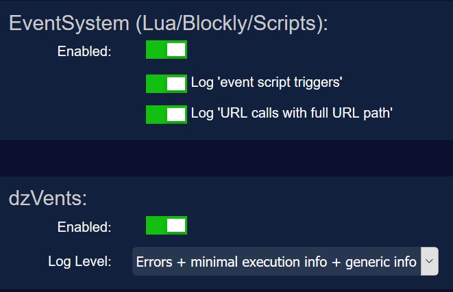

Re: Dzvents timer events not triggered
greenwitch wrote: Wednesday 26 August 2020 20:33 During start of domoticz I have such log:
What are your settings for eventlogging and dzVents loggng?
Can you set them like below ( (setup], [Settings][other] )

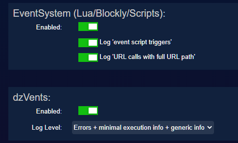

I have it like you suggest. In fact I had it before like this. unfortunately it does not change anything.
Yesterday evening I have installed clear new stable release domoticz and copied only generated scripts + plugins + database + cert file and problem was not solved.
Do you know any mistakes in scripts which can block timer triggering?
