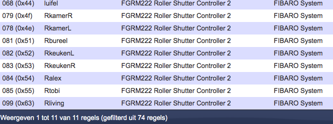

Have several of them and all works perfectly.
Screenshot at aug. 11 17-22-51.png (93.41 KiB) Viewed 367 times
They're configured as blinds percentage:
Screenshot at aug. 11 17-23-49.png (10.56 KiB) Viewed 367 times
