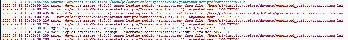

First, I changed all 'ands', except the first one, in line 34 to 'ors'. Using your changes, line 28 still causes an error. I do not get it.
Log zonnescherm.png (41.22 KiB) Viewed 603 times

I tried the last version you sent. This version also contains an error in line 28.

Jan Jansen wrote: Friday 31 July 2020 10:38 Good morning!
waaren wrote: Thursday 30 July 2020 21:08 Can you try this ?
A dot was missing between dz and LOG_DEBUG.

First, I should have seen that dot in line 28 myself. Second, the script works as desired after I modified line 34, thank you both!
