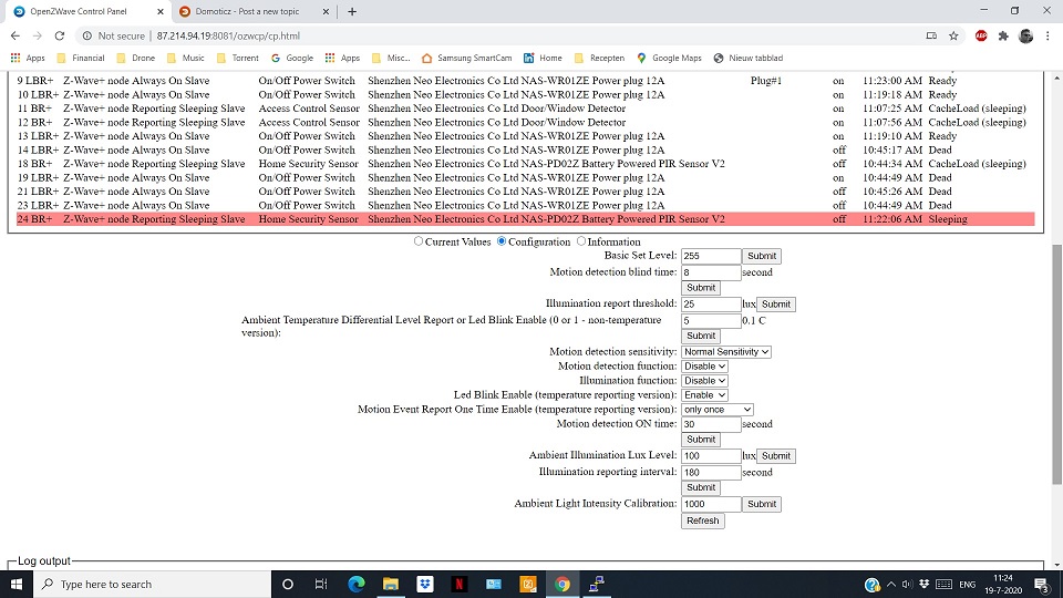

I'm pretty new to ZWAVE and bought some devices. I have added them to the network and working fine. Now I like to change some behaviour of a device (NEO COOLCAM motion sensor) and I can see the parameters of the device in the ZWAVE control panel (see attachment),. but when I Submit the changes it is not Saved?
Any suggestions?

I would use the Zwave control panel in Domoticz itself - goto your Zwave controller - select settings - now you have a list of controlled Zwave devices - select your device and update the settings

Sorry for not responding Snowtiger ;( Thanks for your suggestion, this was working for me!!!
