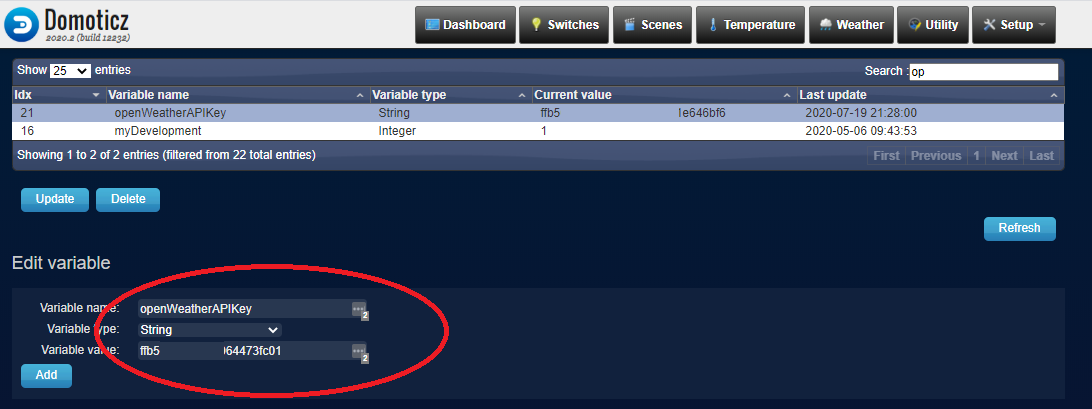

        Next you need to create a uservariable (type string) and enter the openweathermap API key as value

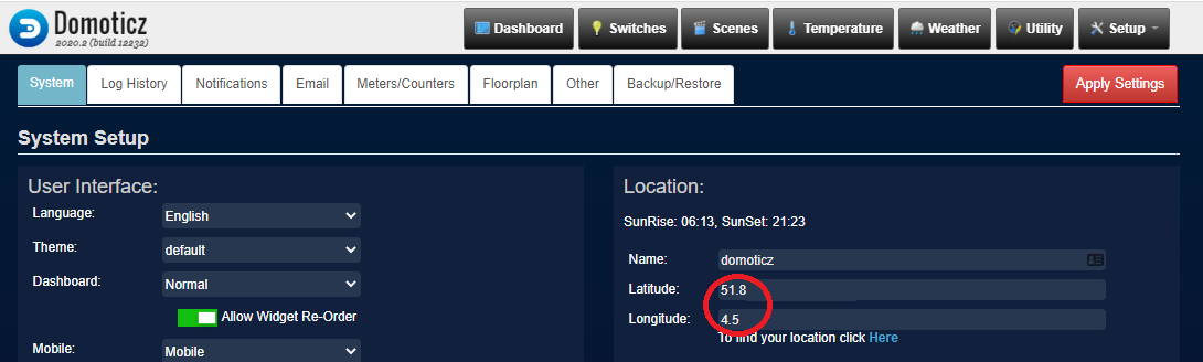

Can you please share your lat /lon (use PM ) to help me debug ?

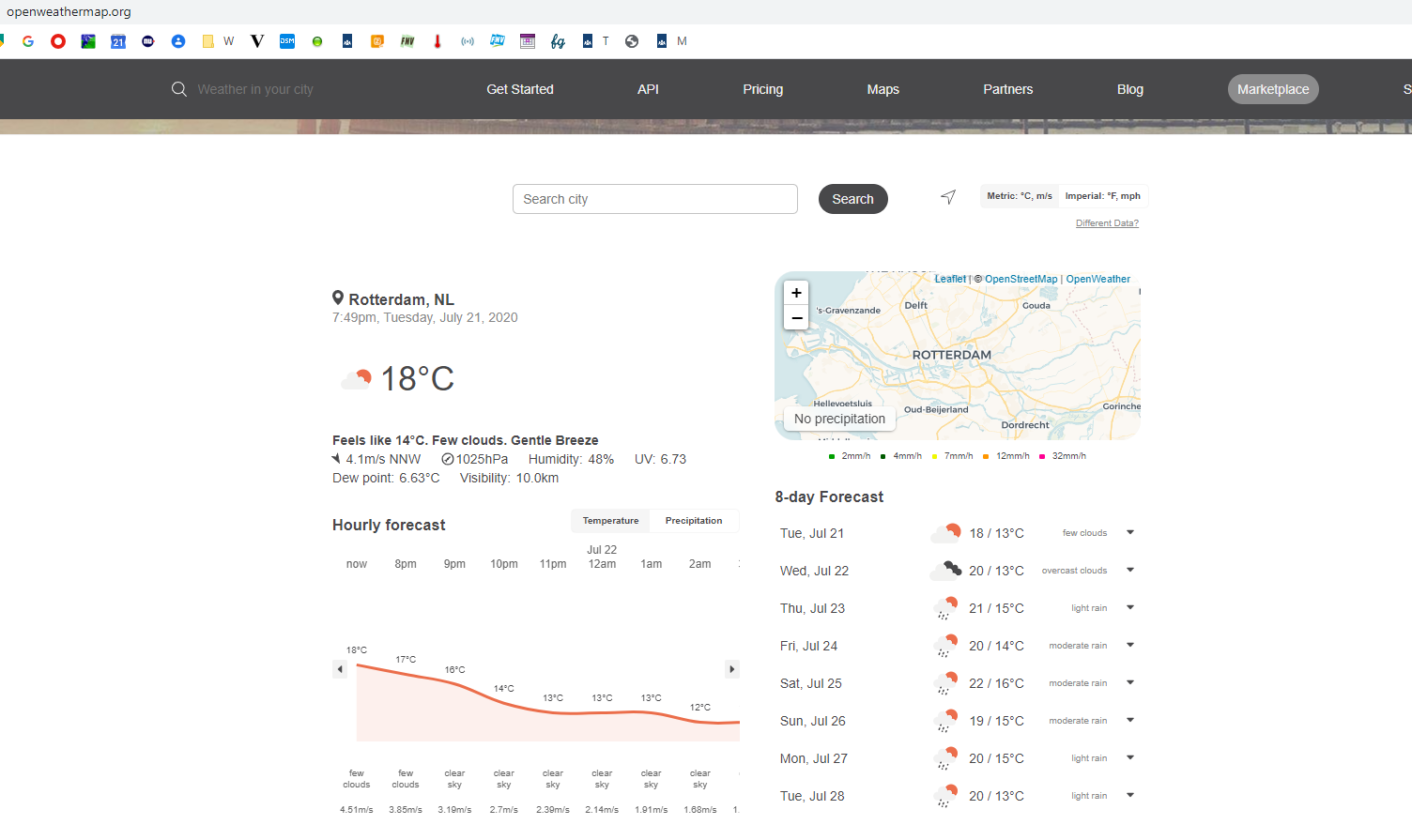

I guessed Budapest and the data from openweathermap GUI matches the API exactly when grabbed at the same time. Maybe the script execution frequency should go to once per hour if you want it to be more accurate for the next couple of hours ?
What devices are you looking at and have you executed the script just before comparing it with the call from your GUI ?

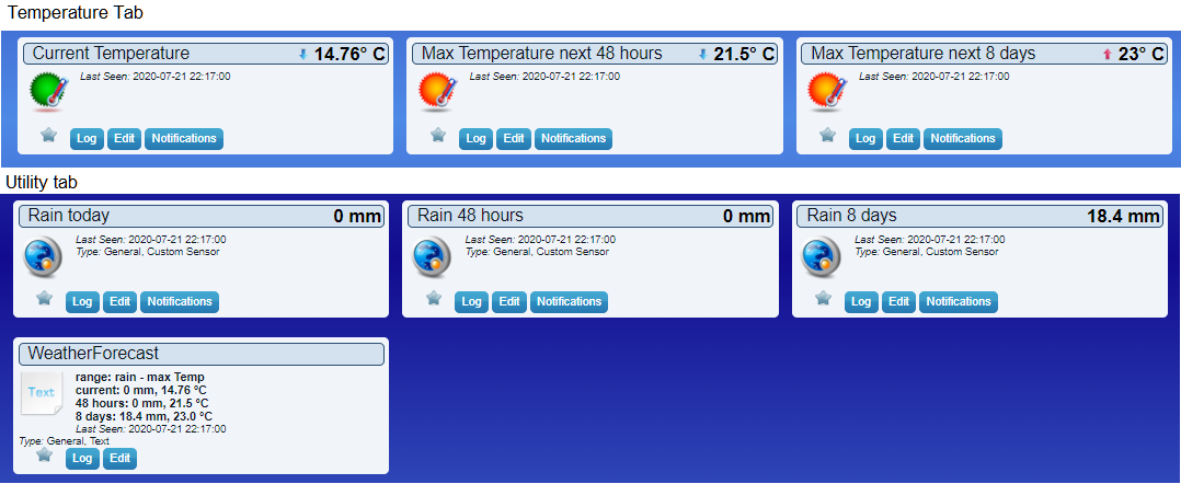

This is what I see and that looks about right

                      '&lat=' .. dz.settings.location.latitude ..
                      '&lon='  .. dz.settings.location.longitude ..
                      '&appid=' .. openWeatherAPIKey,

        You need a free API key to access this data. Read howto get this free API key
        at https://openweathermap.org/guide#how
        Then create the devices you want

Updated version with optional average temperature sensors. Also include a warning in the comments
Please note that dzVents requires acces to domoticz at a sufficient level to retrieve the location settings
including the latititude and longitude. It can only get these if the Local Networks (nu username/password)
include 127.0.0.1 (and ::1 for systems using IPv6)
Also explained in the wiki
        This script collects rain en temperature forecast data from openweathermap.org

        local function updateTextDevice(t)
            local text =   'range:          rain - max Temp'  .. '\n'
            text = text .. 'current:   ' .. t.currentRain .. ' mm, ' .. t.current.temp .. ' °C' .. '\n'
            text = text .. '48 hours:  ' .. t.rain48Hours .. ' mm, ' .. t.maxTemperature48Hours .. ' °C' .. '\n'
            text = text .. '8 days:    ' .. t.rain8Days .. ' mm, ' .. t.maxTemperature8Days .. ' °C' .. '\n'
            weatherText.updateText(text)

Hi Waaren,
How and where do i need to put the APi and lat long?
Re: Multi-day weather forecast to control device
spider85 wrote: Thursday 06 August 2020 14:45 How and where do i need to put the APi and lat long?
the API key goes here
and the lat long goes here
