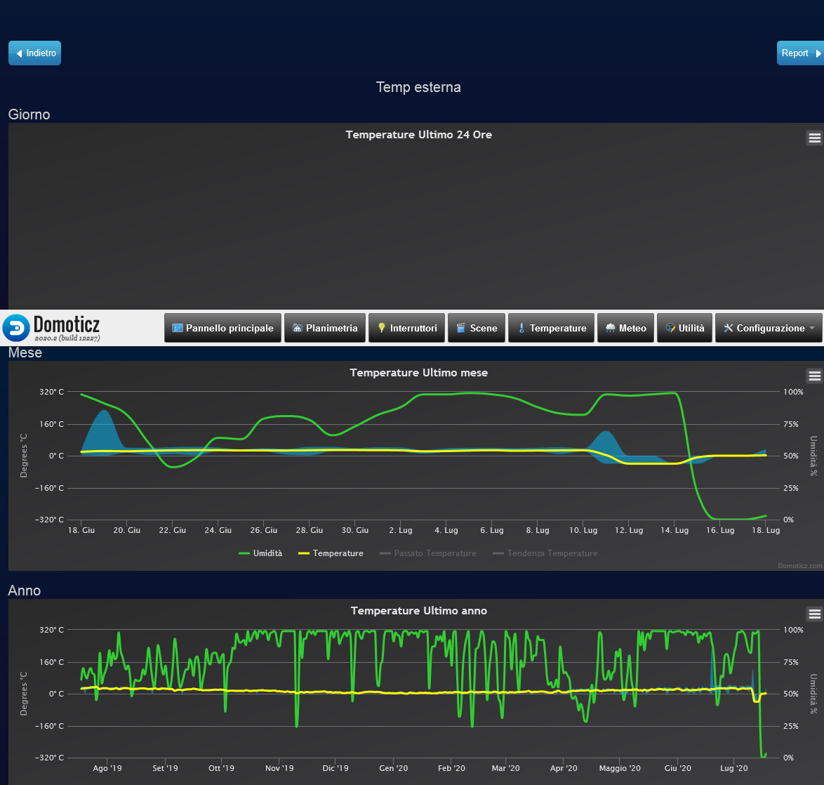

p.s.
i also notice that in every temperature sensor if look the log hystory i'm not able to see the today log, but i'm able to see the last month log and last year log.
the log values related to last month are evry day correct
for other type of devices like energy device or sitch device i can see every log.
it is the issue reported linked?
thanks

Re: Error: SQL Query database disk image is malformed
megamarco83 wrote: Saturday 18 July 2020 19:14 hi, since a couple of days i receive this type of messages every 5minutes:
2020-07-18 19:10:00.459 Error: SQL Query("DELETE FROM Temperature WHERE strftime('%s',datetime('now','localtime')) - strftime('%s',Date) > (SELECT p.nValue * 86400 From Preferences AS p WHERE p.Key='5MinuteHistoryDays')") : database disk image is malformed
maybe because some days ago my temperature sensor dht22 was broken so i can't receive data from it?
now i repaired the sensor and the measuere is ok, how i can solve the database issue? (if it's linked to temperature sensor that was broken)
thanks
Seems your database got corrupted.
please try the check and repair action as in this post

13 04   * * *   root   /var/www/MyScripts/ftpbackup.sh
megamarco83
Posts: 109
Joined: Friday 21 September 2018 15:07
Post by megamarco83 »
sounds good...
i used at 04:01 AM because many devices at that time sleep :-)
i used 01 minutes because every 5minutes (00 05 10 15 20 etc) metern write on a csv file the data, so i choose 4:01
i see that ftp backup required alomst 3minutes and the only big file is database of domoticz that is 5,2Mb the csv files are 1kb max.
i used this backup since many time....but ok, maybe i can postpone the backup at 04:11 AM? should be better?
thanks!!
