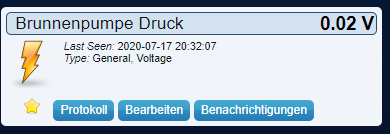

There was a spelling mistake. This is the Sensor with 0-10V
Anmerkung 2020-07-17 220645.png (12.51 KiB) Viewed 2717 times

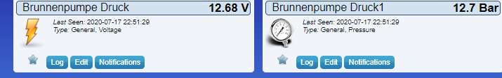

And i will fill this virtual Sensor
Anmerkung 2020-07-17 220646.png (13.89 KiB) Viewed 2717 times
0V is 0 bar and 10V is 10 bar.
For a flow meter i must do the same, but i don´t know the ratio now.
So i would like an example to change the conversion myself.
Thank you in advance for the help!
Re: Sensor Data to virtual Sensor
Wolli82 wrote: Friday 17 July 2020 22:11 So i would like an example to change the conversion myself.
Could look like below in dzVents
Wolli82 wrote: Saturday 18 July 2020 18:38 I have tested the script but unfortunately nothing works. Do you have another idea?
I also tested the script (before posting) and it works as expected. When I update the voltage sensor the pressure sensor gets updated
Please provide more detail about the circumstances and relevant loglines. This will make searching why it does not work for you, easier for other forum members.
So how do you update the voltage meter. And can you show the loglines of this update
