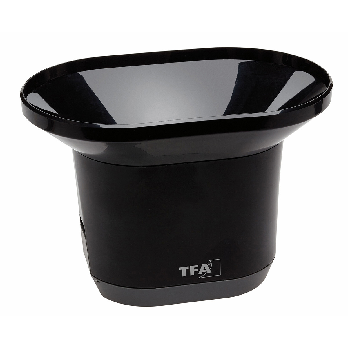

I am trying to use my new TFA-Dostmann Drop Rain Sensor 30.3233.01. This sensor is a 433mhz rain sensor. I am trying to connect it to domoticz using RFXcom433XL with ProXL1 1043 firmware. According to the RFXcom userguide this device is supported on ProXL1 starting at 1042 firmware (Jan 2020). I hooked it up and enabled the "Hideki, TFA, Cresta, UPM" protocol. With both Domoticz, when I allowed adding devices, and RFXmngr I see no data comming in.
Question: Has somebody had any luck reading the data of the above mentioned rain sensor ?
For more info on this sensor see https://www.tfa-dostmann.de/produkt/reg ... r-30-3233/
TFA-Dostmann Rain Sensor 30.3233.01

- TFA 30-3233-01.jpg (150.5 KiB) Viewed 4970 times

Update: The TFA rain sensor now works fine using the rtl_433 RTL-SDR receiver. I get correct Rain readings in Domoticz. In rtl_433 parameters I entered "-R 147" to select the protocol for this TFA device, 30.3233.01. The device measures rain in 0.254 mm steps. Note: The Popp Z-Rain device reports rain in 0.5 mm steps and the Oregon PCR800X wireless rain gauge reports rain in 1.0 mm steps. So for detecting light rain the TFA-Drop rain sensor works best. All 3 rain sensors work great in combination with Domoticz 2020.2 build 12227 (the currently latest beta version)

I bought this Rain Gauge: TFA 30.3233.01
I am running Domoticz 2024.4 on a Raspberry Pi with receiver RFXcom433XL with ProXL1 1043 firmware
According the manual this receiver should support the Rain Gauge
http://www.rfxcom.com/WebRoot/StoreNL2/ ... _Guide.pdf See page 22
In Domoticz I only enabled protocol Hideki/UPM (as listed in the manual). Yet I can't catch any signal.
Do I have to buy and add another receiver?
Any help appreciated!
