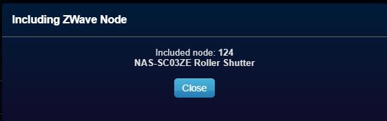

Inclusion
Before including, first calibrate the device using the instructions above or you will not get the correct devices to set the window at some specific percentage.
In Domoticz start 'Add new device' mode. The set the shutter switch in inclusion mode by tapping the middel circle button 3 times fast. Both Up and Down arrows plus the circle will blink 3 times. According to the manual it is a 1 second interval to indicate inclusion mode and during exclusion it blinks at a .5 second interval. I don't see the difference between either though. Then wait for Domoticz to receive the device's information. This may take up to one or 2 minutes: wait patiently. If you rush it, you will most likely fail. Keep the Domoticz log window open to see if any messages are received yet. The messages you are waiting for have "Value_Added" in them. See below for the full list of messages you should see. Once the inclusion in Domoticz is complete you will get this message:
NAS-SC03ZE including.JPG (15.59 KiB) Viewed 689 times
If the "Included" message doesn't show after 2 minutes and no "Value_Added" messages show in the log, try tapping the circle button again. Maybe you were in exclusion mode instead of inclusion mode. Do remember to wait for 2 minutes again before trying another time. You may have to go through this several times before Domoticz will have properly recognised the device. If however at least one "Value_Added" message has been logged, but the "included" message doesn't show yet, wait longer, even if it has been 2 minutes already. The device will repeat any missed messages automatically several times.
