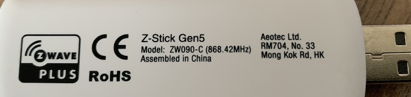

Seems that there are different versions of the stick, see: https://aeotec.freshdesk.com/support/so ... fications-
I'm not sure yet which HW version I've. I've included a picture of the back of the stick.
Reading further, seems that with the old Z-Stick you need an external powered USB HUB to get this working.

Which HW version of the stick do you have? There are 3 different versions. I've included a picture of my stick which I think is older HW.EddyG wrote: Tuesday 30 June 2020 17:48Sorry to mention, but my Gen 5 stick worked fine with /dev/ttyAMA0 on a Pi 4B and Pi 3B+FireWizard wrote: Tuesday 30 June 2020 16:39 Hi,

See also: https://aeotec.freshdesk.com/support/so ... fications-
Z-Stick Gen5 SDK and firmware:
Z-Stick Gen5
RPi4 compatible: Not without unpowered USB Adapter
Recommended USB Adapter with RPi4: Sabrent or Anker unpowered USB hub (2.0 or 3.0)
Firmware Version: V1.00 or V1.01
SDK Version: V6.51.02 or V6.51.10
New Z-Stick Gen5
RPi4 compatible: Yes
Firmware Version: V1.01
SDK Version: V6.51.10
Z-Stick Gen5+
Firmware Version: V1.02
SDK Version: V6.81.06-

Not sure if it is the same or not. But that is not the issue. There is a HW compatibility issue with an older Z-Stick and Raspberry 4. That is clear. Newer sticks should work, older versions need an external powered USB hub. See also posts above.AllesVanZelf wrote: Tuesday 30 June 2020 19:35 I did a fresh install on my rpi3b today, and in the hardware tab, when I select the openzwave hardware, I can choose which usb device to take.
Normally it is /dev/serial/by-id/usb-number. See above picture. Is this not the same on the rpi4?
