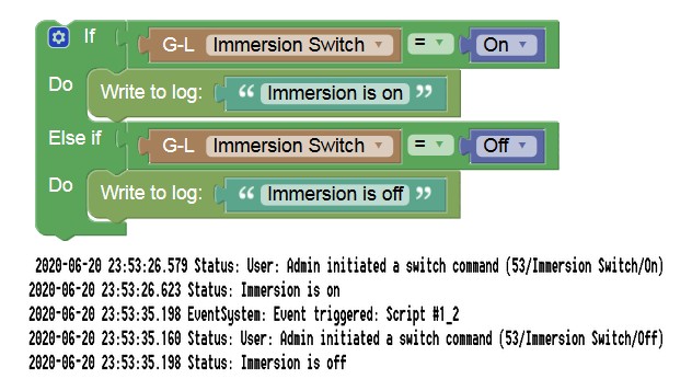

Here is an example with an Else If Do that works
If Do with Else If Do.jpg (60.1 KiB) Viewed 679 times
