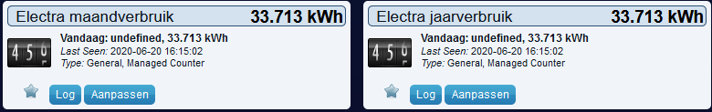

I have two DZ vents scripts :
monthly energy usage and yearly energy usage
Both give me the same outcomes
Device IDX's are correct
Who has a minute or two to look these over with me ?

As you can read from the logs: both outcomes are the same although the ranges are different ?
And they don't give me the correct monthly values too
I'm lost here.. who has the definitive answer ... Waaren ? ;-)

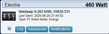

Can you also post a screenshot from device 69 ? If this device is a two tariff smartmeter you should also look at rt[id].v2 (low tariff) to get the right results.

waaren wrote: Saturday 20 June 2020 17:09 Can you also post a screenshot from device 69 ? If this device is a two tariff smartmeter you should also look at rt[id].v2 (low tariff) to get the right results.
</quote>
it is, just the P1 energy sensor, both low and high tarif indeed
I'll get back to you and try to implement your suggestions.

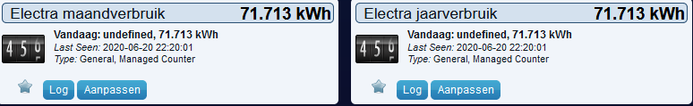

Ok code is back in order now... little mistake,
But even after I implemented your alterations correctly, the outcomes stay the same and far too high
Doing the debug feature now, see what that brings me...

2020-06-20 22:26:00.793 Status: dzVents: Debug: energyYearTotal: Processing device-adapter for Electra: P1 smart meter energy device adapter
2020-06-20 22:26:00.795 Status: dzVents: Debug: energyYearTotal: Processing device-adapter for Electra jaarverbruik: Counter device adapter
2020-06-20 22:26:00.795 Status: dzVents: Debug: energyYearTotal: 2020-06-13 ==>> 9.881 + 0.000 = 9.881
2020-06-20 22:26:00.795 Status: dzVents: Debug: energyYearTotal: 2020-06-14 ==>> 8.330 + 0.000 = 8.33
2020-06-20 22:26:00.795 Status: dzVents: Debug: energyYearTotal: 2020-06-15 ==>> 2.175 + 5.836 = 8.011
2020-06-20 22:26:00.795 Status: dzVents: Debug: energyYearTotal: 2020-06-16 ==>> 2.577 + 6.070 = 8.647
2020-06-20 22:26:00.795 Status: dzVents: Debug: energyYearTotal: 2020-06-17 ==>> 2.613 + 7.843 = 10.456
2020-06-20 22:26:00.795 Status: dzVents: Debug: energyYearTotal: 2020-06-18 ==>> 2.150 + 9.293 = 11.443
2020-06-20 22:26:00.795 Status: dzVents: Debug: energyYearTotal: 2020-06-19 ==>> 1.697 + 6.738 = 8.435
2020-06-20 22:26:00.795 Status: dzVents: Debug: energyYearTotal: 2020-06-20 ==>> 6.549 + 0.000 = 6.549
2020-06-20 22:26:00.795 Status: dzVents: Info: energyYearTotal: ------ Finished Electra jaarverbruik totaal
2020-06-20 22:26:00.795 Status: EventSystem: Script event triggered: /home/pi/domoticz/dzVents/runtime/dzVents.lua
2020-06-20 22:26:00.882 Status: dzVents: Info: Handling httpResponse-events for: "energyMonthTotal_month"
2020-06-20 22:26:00.882 Status: dzVents: Info: energyMonthTotal: ------ Start internal script: Electra maandverbruik totaal: HTTPResponse: "energyMonthTotal_month"
2020-06-20 22:26:00.903 Status: dzVents: Debug: energyMonthTotal: Processing device-adapter for Electra: P1 smart meter energy device adapter
2020-06-20 22:26:00.904 Status: dzVents: Debug: energyMonthTotal: Processing device-adapter for Electra maandverbruik: Counter device adapter
2020-06-20 22:26:00.904 Status: dzVents: Debug: energyMonthTotal: 2020-06-13 ==>> 9.881 + 0.000 = 9.881
2020-06-20 22:26:00.904 Status: dzVents: Debug: energyMonthTotal: 2020-06-14 ==>> 8.330 + 0.000 = 8.33
2020-06-20 22:26:00.904 Status: dzVents: Debug: energyMonthTotal: 2020-06-15 ==>> 2.175 + 5.836 = 8.011
2020-06-20 22:26:00.904 Status: dzVents: Debug: energyMonthTotal: 2020-06-16 ==>> 2.577 + 6.070 = 8.647
2020-06-20 22:26:00.904 Status: dzVents: Debug: energyMonthTotal: 2020-06-17 ==>> 2.613 + 7.843 = 10.456
2020-06-20 22:26:00.904 Status: dzVents: Debug: energyMonthTotal: 2020-06-18 ==>> 2.150 + 9.293 = 11.443
2020-06-20 22:26:00.904 Status: dzVents: Debug: energyMonthTotal: 2020-06-19 ==>> 1.697 + 6.738 = 8.435
2020-06-20 22:26:00.904 Status: dzVents: Debug: energyMonthTotal: 2020-06-20 ==>> 6.549 + 0.000 = 6.549
2020-06-20 22:26:00.905 Status: dzVents: Info: energyMonthTotal: ------ Finished Electra maandverbruik totaal
Still is giving me the same results ..hmmm

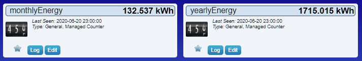

All year and month totals are getting added up. How to cope with that issue ?
Pfff, this is almost like working ;-)
"Life is too short for bad coffee"
Re: Same outcome of monthly and yearly energy usage scripts
MadMedic wrote: Saturday 20 June 2020 22:48 looking at the graph data I noticed that year energy is not v and v2
c values are total counters. You don't' want these, you really need v and v2. The devices are updated with kWh values.
Because you only have history from the current month, the total for current month and current year are equal. Next month you will see a difference.

You made me smile... I got way too deep on this code. You make total sense.
Impulsiveness is my middle name, unfortunately ;-)
thnx, Waaren

Ok, enough for today, altered the code back to v and v2.
Last question:
Any thoughts about the offset and divider on the managed counter button ?
Both 0 ?
MadMedic wrote: Saturday 20 June 2020 23:23 Any thoughts about the offset and divider on the managed counter button ?
Your setting is ok
