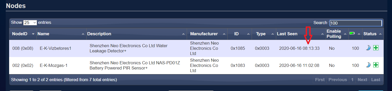

Please help me solve my problem!
With Dzvents, I want to read and interpret the last update time of a battery-powered hardware. I wrote hardware directly because the tool only updates on the hardware side during the wake up, not in the tools tab.
I would use this value to detect zombie, detached devices, but there is no way I can extract value with an arrow.
I read this: https://www.domoticz.com/forum/viewtopi ... 59&t=32730
but it didn't help because I don't see it as having lastupdate value
Thanks.

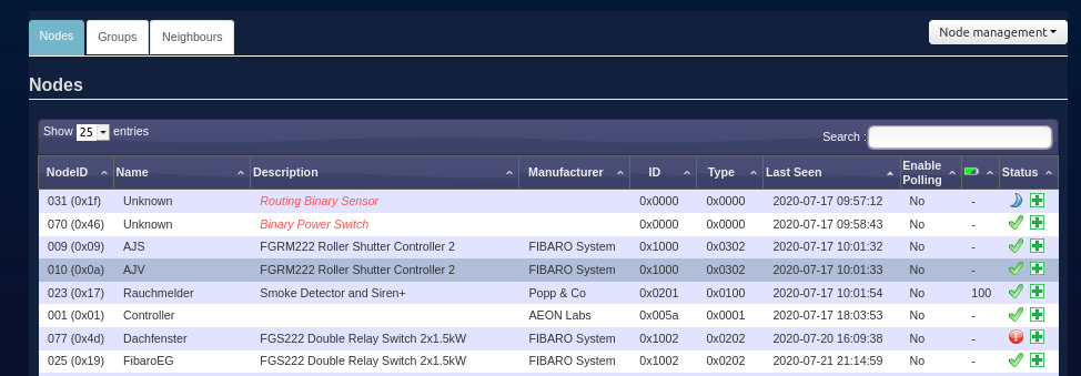

I jumped in here, because I have a similar question or issue. I tried the code for a fibaro double relais who randomly become dead. My domoticz log
2020-07-22 11:20:01.744 Error: dzVents: Error: (3.0.11) getZwaveNodes: An error occurred when calling event handler Zombie
2020-07-22 11:20:01.744 Error: dzVents: Error: (3.0.11) getZwaveNodes: ...pi/domoticz/scripts/dzVents/generated_scripts/Zombie.lua:39: bad argument #1 to 'ipairs' (table expected, got nil)
This is the code I use.

I even don't know if last seen can work because as shown in my screenshot some devices are last seen a couple of days ago but still alive. How does Domoticz notice that a device is dead? Can this be use in dzvents?
I found that follow command should refresh node info. But I just get an error in my browser.
httpS://IP:port/json.htm?type=command&param=requestzwavenodeinfo&idx=X
