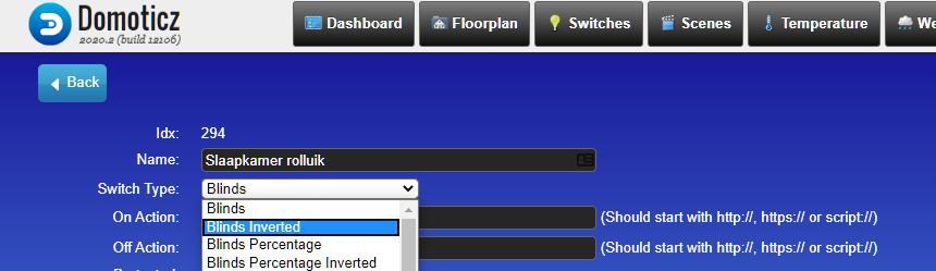

The only thing is that I have 2 Intertechno ITL-500 devices connected to the HomeWizard for rollershutter. On HomeWizard the UP and DOWN commands work as they should. But with Domoticz the commands are reversed: UP is DOWN and DOWN is UP. But I can't change the options of these items. It doesn't work to set new commands for the ON and OFF options.

Can't you change the device type in the edit window of the device?
(Click the edit button on the device on the switch tab)

Your hint was very helpful. I changed the switch type to "Blind Inverted". This is working very good :D.
