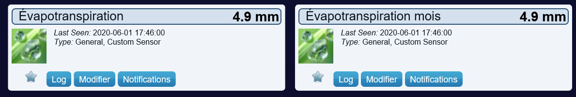

I'm calculating ET from meteo values for watering my garden. I successful store the result in a dummy rain sensor, it does the job quite well :-)

Here is my script to calculate EVP based on weather sensors. Calculations are from Penman Monteith formula and FAO-56 method (http://edis.ifas.ufl.edu/pdffiles/ae/ae45900.pdf). The code below is an extraction from my global watering script, so maybe I introduced some syntax bug on the process. If you notice any, let me know I'll correct them.
-- Script to estimate potential evapotranspiration according to Penman Monteith formula and FAO-56 method
-- Weather sensors for EVP
local dev_THB="Conditions extérieures" -- Outside temperature (°C), relative humidity (%) and Atmospheric pressure (hPa)
local dev_Rn= "Lux"                    -- Global sun radiation (lux)
local cst_G = 0                        -- Thermal flux to the ground (MJ/h/m²)
local dev_U = "Vent"                   -- Wind speed
local cst_h = 5                        -- height of wind speed mesurement (m)
-- EVP sensor (must be of type rain sensor)
local dev_EVP="EVP"
local debug=false
local frequency_EVP=1 -- script runs every 1 min with local wind meter; can be slowed down to 1h with stabile wind measurements
function UpdateDev(device,nvalue,svalues)
    -- Update a domoticz device
    if device~=nil then
        commandArray[#commandArray+1] = {['UpdateDevice'] = otherdevices_idx[device]..'|'..tostring(nvalue)..'|'..tostring(svalues)}
time = os.date("*t")
if  (time.min % frequency_EVP)==0  then -- Run every "frequency_EVP" minutes.
    --Constants
    Cn=37 --Hourly steps...
    if (timeofday['Daytime']) then
        Cd=0.24 --at day and 0.96 at night !!
        Cd=0.96
    if debug then print("Cd="..tostring(Cd)) end
    -- reading of sensors
    P =otherdevices_barometer[dev_THB]     -- hPa
    T =otherdevices_temperature[dev_THB]   -- °C
    Hr=otherdevices_humidity[dev_THB]      -- %
    Rn=otherdevices_svalues[dev_Rn]*0.0079 -- W/m²
    U2=otherdevices_windspeed[dev_U]       -- m/s
    if debug then
        print("Pressure "..tostring(P).." hPa")
        print("Temperature "..tostring(T).." °C")
        print("Relative humidity "..tostring(Hr).." %")
        print("Solar irradiance "..tostring(Rn).." W/m²")
        print("Wind speed "..tostring(U2*3.6).." km/h") -- Wind speed is internally stored in m/s
    -- unit convertions
    P=P/10 -- must be in kPa
    Hr=Hr/100
    Rn=Rn/277.77778 -- must be in MJ/h/m²
    U2=U2*4.87/math.log(67.8*cst_h-5.42) -- windspeed at 2m height, in m/s
    -- Intermediates calculations
    Esat=0.6108*math.exp(17.27*T/(T+237.3)) -- saturated vapor pressure (kPa)
    Ea  =Hr*Esat                            -- current vapor pressure (kPa)
    Delta=4098*Esat/((T+237.3)^2)
    Gamma=0.665*P/1000
    if debug then
        print("Pressure of saturated vapor "..tostring(Esat).." kPa")
        print("Pressure of actual vapor "..tostring(Ea).." kPa")
        print("Delta "..tostring(Delta))
        print("Gamma "..tostring(Gamma))
    ET0=(0.408*Delta*(Rn-cst_G)+Gamma*Cn/(T+273)*U2*(Esat-Ea))/(Delta+Gamma*(1+Cd*U2)) -- EVP in mm/h
    if debug then print("ET0 "..tostring(ET0).." mm/h") end
    -- Updating the counter
    -- EVP_Act=otherdevices_rain[dev_EVP] buggy :( Get an offset at midnight
    rate, EVP_Act = string.match(otherdevices_svalues[dev_EVP],"(.-);(.-)$")
    if debug then
        print("rate "..tostring(rate))
        print("EVP_Act "..tostring(EVP_Act))
        print("EVP Ct b4 "..otherdevices_svalues[dev_EVP])
    svalue=tostring(ET0)..";"..tostring(EVP_Act+ET0*frequency_EVP/60)
    UpdateDev(dev_EVP,0,svalue)
return commandArray
For solar irradiance, I don't have a sensor :-( so I'm using estimation from this script, but it works rather well :-)

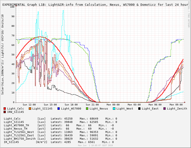

Because my PWSes are lacking a light-sensor, I made some experimental setups linked to Domoticz.
See the attached graph with results for yesterday and today: the weather is quiet, with sunny clear sky.
Beware, that the graph shows unfiltered, hardly calibrated measured data => levels from sensors are not absolute & correct!!!!!
The thick red line (=Light Calc) is coming from the same algorithm you apply,
with pressure from local barometer in Domoticz (not PWS, but better BMP180+BME280) and octa straight from Ogimet.
SI1145 is a dualsensor looking up, reading light & IR (and calculating UV, but that is not in this graph)
WS7000_TH and Nexus_TH are modified thermo-sensors (= LDR and/or Photodiode at place of NTC-resistor) with line-of-sight at approx. +45 degrees elevation
TLS2561_East, TLS2561_West and BH1750_Zenith are 'real' lightsensors, aimed in the indicated directions.
My evaluations/observations:
- the red line from the calculation is nicely smooth with a graph to be expected for this undisturbed weather,
- the curves from the modified sensors have almost no resemblance to real light-intensity (but more a 'light presence-indication', somewhat useful to calculate sunduration),
- some 'real' sensors are heavily fluctuating (although sky is clear) probably due to their high sensitivity and due to obstruction by trees etc.
As 'real' sensor the SI1145 presently seems best, approaching the calculated curve.
Under another 'project' I found that MAX44009 is also a very good sensor.
My experience now is that the position and aiming of a light sensor is very critical for intial stable data:
- zenith scanning has least problems related to obstructions
- filtering of the data may help by smoothing, but not too much.

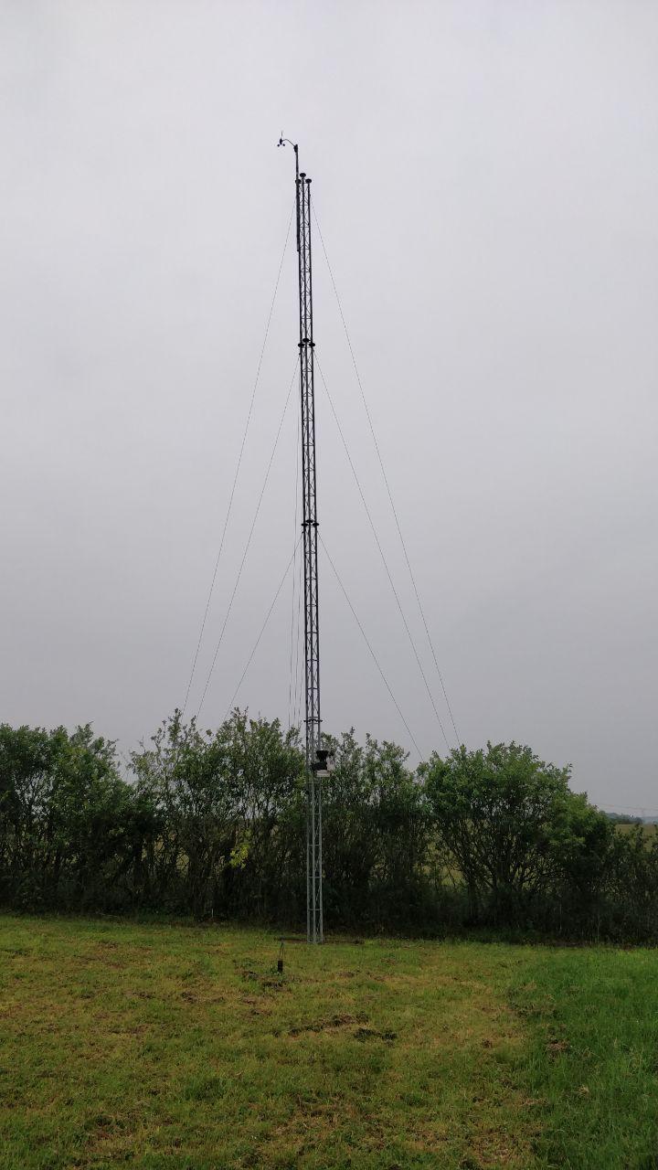

When I see what you have achieved guys, I feel a bit lazy since VP Pro 2 delivers updated values every minutes and computes the accumulated month value. I ran Meteohub for more than 10 years and I just transitionned to Meteobridge Nano HD https://www.meteobridge.com/wiki/index. ... ge_NANO_SD, which is a terrific module. Thanks to the template functionnality https://www.meteobridge.com/wiki/index.php/Templates it is straightforward to get the desired values every minutes with a dzVents script. I just remembered that Custom sensor is at our disposal. I grabbed an icon on the Web, resized it and imported it in domoticz (pretty tricky process). Here is the result.
Basically here is my dzVents script to grab various meteo value, either directly from VP2 or thanks to wunderground API. Some code is deprecated I haven't removed yet. I wish Domitcz tick is one second instead of one minute in order to get gust value every, say, 5 seconds. This is achievable either with cron or the new emitEvent command. I may give a try some day.
I take this opportunity to thank waaren who is always reacting promptly to questions and give good advices.
Meteo rig
Station météo.jpg (101.05 KiB) Viewed 3385 times

					dz.devices(432).updateCustomSensor(evapotranspirationDay)
					dz.devices(433).updateCustomSensor(evapotranspirationMonth)

Wow ! That's a big mast :o
Number8
Posts: 374
Joined: Friday 23 May 2014 7:55
Domoticz version: 2022.1
Location: Saint Pierre de Jards
Re: Evapotranspiration widget
Post by Number8 »
Anemometer is at 13m from ground
Debian buster on NUC and three RPi with buster.
