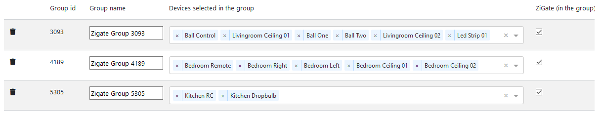

So I have three IKEA remote controls, bedroom, kitchen and livingroom (Ball control). The remotes and lights are paired with each other in respective groups and also with the zigate controller.
For a while they worked good but now they have gone haywire. All three controls work where they should with on/off/intensity but the color thing is fubared. All three controls change the colors in the livingroom and do nothing in their respective areas.

When you mention remote I assumed this is the 5 Buttons Ikea Tradfri remote ? If so, are they respectively part of their corresponding group ?

The remotes are paired with the corresponding groups as shown in picture above (the remotes are the first item in each group). They behave like they should with light/onofff/intensity. The groups were created by the remotes touchlink thing.
