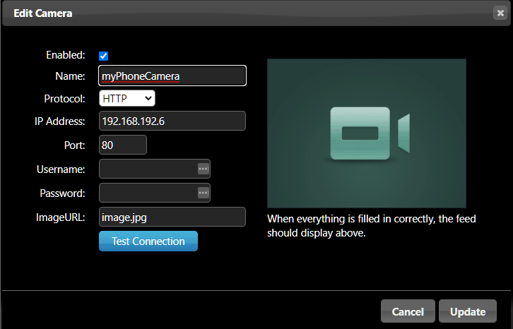

I have this to get a picture from my Android phone. So no full URL only the name of the image.rick8245 wrote: Sunday 24 May 2020 16:27 This rtsp url works in VLC player but when I enter it in the imageurl field in Domoticz It does not show anything.

- waaren
- Posts: 6028
Re: Where to find the imagetype (JPG) for the ImageURL ?
I don't know.
Domoticz just sends <protocol>://<IP address>/<imageURL>
to the camera
so in my example
http://192.168.192.6/image.jpg
and that call returns the image. So you have to know what the command (the part after the IP address) for your camera is to get the image.
