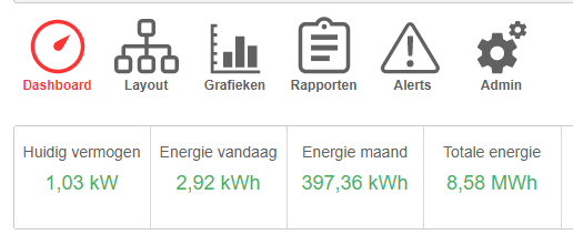

Is there no figure for the Total Lifetime Energy? (Totale energie) I could not find it in the test output.
https://monitoring.solaredge.com/solare ... ut/logical
imo This a counter within the Inverter? At least it is also available on the monitor homepage.
