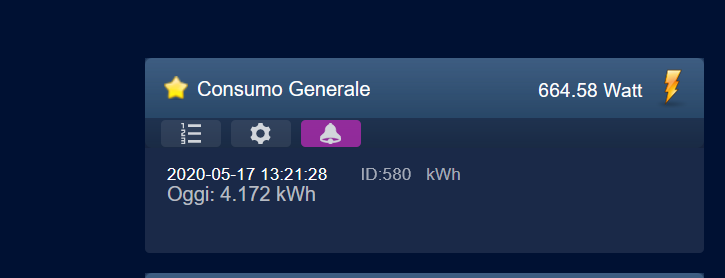

device name is : Consumo generale and is power meter type
Re: Notification time overcoming Watt
djdevil wrote: Sunday 17 May 2020 13:23 device name is : Consumo generale and is power meter type
Can you please state the type / subtype as in the devices tab and in English like below
devices.tab
devices.tab
devices tab.png (78.54 KiB) Viewed 1615 times

oh yes type "General" SubType "kWh"
