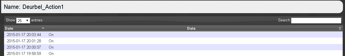

Heisenberg
- Posts: 135
- Joined: Monday 27 January 2014 14:12
Re: Supported Doorbells by Domoticz?
Yes! When I follow your instructions then Domoticz indeed automatically recognize the device as Type 'Chime' and Subtype 'SelectPlus'. But when I push the doorbell button it doesn't appear in the log but de doorbell does ring. But when I push the button in Domoticz it doesn't ring.Siewert308SW wrote:RFXtrx433_Ext_236

Pull the battery out of the doorbell and pull the chime out of the 220v socket.
Wait a minute to let all electric flow out of the doorbell.
Then put the battery back in the doorbell and select learn in domoticz and press the doorbell button.
Edit: after restarting Domoticz I can see the Chime in the logging and works if I push the doorbell button. Still pushing the button in Domoticz doesn't ring the bell.
Edit 2: after pull out the chime of the 220v socket and put it back in now everything works!

Great... as i told you. pull the plug.
The chime has to learn also...
