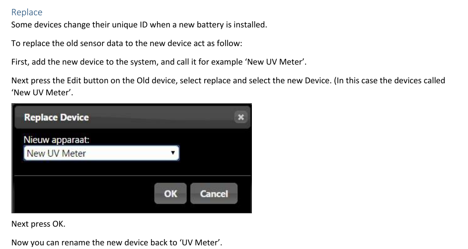

I have a tempdevice with logdata for more then a year.
It was neccesary to replace the battery. After connecting the new battery Domoticz will see a new device with an empty logfile.
Is it possible to merge the old logfile with the new one?
If possible where to find a “how to” ?
Thanks for the help
Paul
Re: Transfer logdata
pgas37 wrote: Tuesday 05 May 2020 9:10 Is it possible to merge the old logfile with the new one?
Most important part is to have/make a copy of your database with the logdata of the old device.
If you have that there are several methods to merge the data
You can first try the one described here Which is essentially the procedure described on page 20 of the manual. (see below)

So, so simply if you know the trick...
thanks
