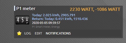

I just wanted to ask if there would be an option to merge 2 values from a P1 meter. The current usage only reflects one value. The return is not seen in Dashticz or is reported in a positive value. Very confusing. It is possible to do this in the graph section, which works rather fine!
To explain it a bit more, my p1 meter in domoticz reports 99watt (usage), -1517watt (return). I only see the last number reported in dashticz, and it is always positive. I would like to report 99-1517 = -1418watt in this example.

Yes, it is definitely possible. I have a 3-phase connection. Return is on phase number 1 only. But there is usage on the other 2 phases (also on phase 1). These are reported in the p1 meter as the netto usage on phase 1 (which can be return), and if that is the case 2 values are reported. See attachment jpg.

In Domoticz I have 3 voltage sensors, 3x return and 3x usage. And the current use as pictured above and totals.
I have managed to get both values in one block. Now the question, how to substract both from each other. Usage-UsageDeliv.
