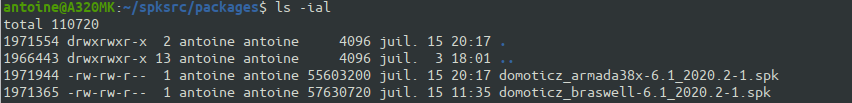

Some news about my tests regarding Synology domoticz package generation. I succeeded to generate a package using the synocommunity spksrc tool for one (braswell) of the 64 bits Synology architecture.
Once the tool installed in my user home directory (i.e. ~), here is the files edited:
1. Version 1.72 of boost library used by modifying version number in Makefile and also PLIST in ~/spksrc/cross/boost
Makefile
PKG_NAME = boost
PKG_VERS = 1.72.0
PKG_EXT = tar.bz2
PKG_DIR = $(PKG_NAME)_$(subst .,_,$(PKG_VERS))
PKG_DIST_NAME = $(PKG_DIR).$(PKG_EXT)
PKG_DIST_SITE = http://sourceforge.net/projects/$(PKG_NAME)/files/$(PKG_NAME)/$(PKG_VERS)
PLIST
lnk:lib/libboost_*.so
lib:lib/libboost_*.so.1.72.0
2. ~/spksrc/cross/domoticz/Makefile
PKG_NAME = domoticz
PKG_VERS = 2020.2
PKG_EXT = tar.gz
PKG_DIST_NAME = $(PKG_VERS).$(PKG_EXT)
PKG_DIST_SITE = https://github.com/domoticz/domoticz/archive
PKG_DIST_FILE = $(PKG_NAME)-$(PKG_VERS).$(PKG_EXT)
PKG_DIR = $(PKG_NAME)-$(PKG_VERS)
DEPENDS = cross/boost cross/curl cross/python3 cross/lua
HOMEPAGE = http://www.domoticz.com/
COMMENT  = Domoticz is a Home Automation System.
LICENSE  = GPL-3.0
CONFIGURE_TARGET = domoticz_configure
INSTALL_TARGET = domoticz_install
BOOST_LIBRARIES = system thread date_time
ENV += BOOST_LIBRARIES="$(BOOST_LIBRARIES)" CMAKE_INCLUDE_PATH="$(STAGING_INSTALL_PREFIX)/include" CMAKE_LIBRARY_PATH="$(STAGING_INSTALL_PREFIX)/lib" PCH_COMPILE_FLAGS="$(CFLAGS)"
include ../../mk/spksrc.cross-cc.mk
.PHONY: domoticz_configure
domoticz_configure:
	$(RUN) cmake CMakeLists.txt
.PHONY: domoticz_install
domoticz_install:
	@mkdir -p $(STAGING_INSTALL_PREFIX)/bin
	@$(RUN) install -m 755 domoticz $(STAGING_INSTALL_PREFIX)/bin
	@$(RUN) cp -R www $(STAGING_INSTALL_PREFIX)
	@$(RUN) cp -R Config $(STAGING_INSTALL_PREFIX)
	@$(RUN) cp -R scripts $(STAGING_INSTALL_PREFIX)
	@mkdir -p $(STAGING_INSTALL_PREFIX)/var
3. ~/spksrc/cross/domoticz/work-braswell-6.1/domoticz-2002.2/CMakeLists.txt
#set to minimum version that supports clean build
cmake_minimum_required(VERSION 3.16.0)
project(domoticz)
INCLUDE(CheckIncludeFile)
INCLUDE(CheckIncludeFiles)
INCLUDE(InstallRequiredSystemLibraries)
INCLUDE(TestBigEndian)
### DEPENDENCY VERSIONS
## required min. libBoost version
SET(DOMO_MIN_LIBBOOST_VERSION 1.66.0)
### USER-SETTABLE OPTIONS
# Bundled libraries
option(USE_BUILTIN_JSONCPP "Use builtin JSonCPP" YES)
option(USE_BUILTIN_MINIZIP "Use builtin Minizip" YES)
option(USE_BUILTIN_MQTT "Use builtin Mosquitto library" YES)
option(USE_BUILTIN_SQLITE "Use builtin sqlite library" YES)
# Optional dependencies
option(USE_PYTHON "Use Python for Plugins and Event-Scripts" YES)
option(INCLUDE_LINUX_I2C "Include I2C support" YES)
option(INCLUDE_SPI "Include SPI support" YES)
option(WITH_LIBUSB "Enable libusb support" YES)
# Link static or shared, external dependencies
option(USE_LUA_STATIC "Link LUA static" YES)
option(USE_OPENSSL_STATIC "Link OpenSSL static" NO)
option(USE_STATIC_BOOST "Build with static BOOST libraries" YES)
option(USE_STATIC_OPENZWAVE "Build with static OpenZwave libraries" YES)
# Developer-oriented options
option(USE_PRECOMPILED_HEADER "Use precompiled header feature to speed up build time " YES)
option(GIT_SUBMODULE "Check submodules during build" ON)
### COMPILER SETTINGS
if (CMAKE_CXX_COMPILER_ID MATCHES "Clang")
  set(CMAKE_CXX_STANDARD 11)
  set(CMAKE_CXX_STANDARD_REQUIRED ON)
  set(CXX_EXTENSIONS NO)
endif()
IF(CMAKE_SYSTEM_NAME STREQUAL "Darwin")
  set(CMAKE_CXX_FLAGS "${CMAKE_CXX_FLAGS} -Wno-switch -Wno-parentheses-equality -Wno-deprecated-declarations -Wno-tautological-compare -Wno-unused-value -Wno-comment -Wno-unsequenced -Wno-logical-op-parentheses -Wno-literal-conversion")
ENDIF()
IF(CMAKE_SYSTEM_NAME STREQUAL "OpenBSD")
  set(CMAKE_CXX_FLAGS "${CMAKE_CXX_FLAGS} -pthread")
ENDIF()
IF(CMAKE_SYSTEM_NAME STREQUAL "NetBSD")
ENDIF()
IF(CMAKE_COMPILER_IS_GNUCXX)
  SET(CMAKE_CXX_FLAGS "${CMAKE_CXX_FLAGS} -std=c++11 -Wno-psabi -rdynamic")
  #SET(CMAKE_C_FLAGS "${CMAKE_C_FLAGS} -Wno-switch")
  #ADD_DEFINITIONS( -Wall -O0 -ggdb )
  #ADD_DEFINITIONS( -Wfatal-errors -Wformat=2 -Werror=format-security )
ENDIF()
### VERSIONING SUPPORT
MACRO(History_GET_REVISION variable)
  IF(EXISTS ${CMAKE_SOURCE_DIR}/History.txt)
    MESSAGE(STATUS "Read ProjectRevision from History.txt")
    CMAKE_POLICY(SET CMP0007 NEW)
    FILE(STRINGS ${CMAKE_SOURCE_DIR}/History.txt AppVersionContent)
    LIST(GET AppVersionContent 0 AppVersionContent)
    STRING(REPLACE " " ";" AppVersionContent ${AppVersionContent})
    LIST(GET AppVersionContent 1 AppVersionContent)
    STRING(REPLACE "." ";" AppVersionContent ${AppVersionContent})
    LIST(GET AppVersionContent 1 ${variable})
  ELSE(EXISTS ${CMAKE_SOURCE_DIR}/History.txt)
    MESSAGE(STATUS "Failed to get ProjectRevision from History.txt, set it to 0")
    set (${variable} 0)
  ENDIF(EXISTS ${CMAKE_SOURCE_DIR}/History.txt)
ENDMACRO(History_GET_REVISION)
MACRO(Gitversion_GET_REVISION dir variable)
  EXECUTE_PROCESS(COMMAND ${GIT_EXECUTABLE} --git-dir ./.git rev-list HEAD --count
    WORKING_DIRECTORY ${dir}
    OUTPUT_VARIABLE ${variable}
    OUTPUT_STRIP_TRAILING_WHITESPACE)
ENDMACRO(Gitversion_GET_REVISION)
find_package(Git QUIET)
Gitversion_GET_REVISION("${CMAKE_SOURCE_DIR}" ProjectRevision)
IF(NOT ProjectRevision)
  MESSAGE(STATUS "Failed to get ProjectRevision from git")
  History_GET_REVISION(ProjectRevision)
ELSE(NOT ProjectRevision)
  MATH(EXPR ProjectRevision "${ProjectRevision}+2107")
ENDIF(NOT ProjectRevision)
### SUBMODULE / BUNDLED SOFTWARE
if(GIT_FOUND AND EXISTS "${PROJECT_SOURCE_DIR}/.git")
# Update submodules as needed
    if(GIT_SUBMODULE)
        message(STATUS "Submodule update")
    execute_process(COMMAND ${GIT_EXECUTABLE} submodule update --init --recursive
                        WORKING_DIRECTORY ${CMAKE_CURRENT_SOURCE_DIR}
                        RESULT_VARIABLE GIT_SUBMOD_RESULT)
        if(NOT GIT_SUBMOD_RESULT EQUAL "0")
            message(FATAL_ERROR "git submodule update --init failed with ${GIT_SUBMOD_RESULT}, please checkout submodules")
        endif()
    endif()
endif()
if(USE_BUILTIN_JSONCPP AND NOT EXISTS "${PROJECT_SOURCE_DIR}/extern/jsoncpp/CMakeLists.txt")
  message(FATAL_ERROR "The submodules were not downloaded! GIT_SUBMODULE was turned off or failed. Please update submodules and try again.")
endif()
if(USE_BUILTIN_MINIZIP AND NOT EXISTS "${PROJECT_SOURCE_DIR}/extern/minizip/CMakeLists.txt")
endif()
if(USE_BUILTIN_MQTT AND NOT EXISTS "${PROJECT_SOURCE_DIR}/extern/mosquitto/CMakeLists.txt")

It works also for 32 bits address model of Synology like the armada38X (DS216j for example). But in this case, I have to use version 1.66.0 of Boost library. It seems latest Boost library version can't be currently compiled. I've opened an issue: https://github.com/SynoCommunity/spksrc/issues/4069
Screenshot from 2020-07-15 20-18-14.png (24.78 KiB) Viewed 2292 times
