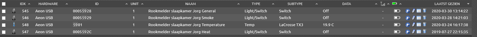

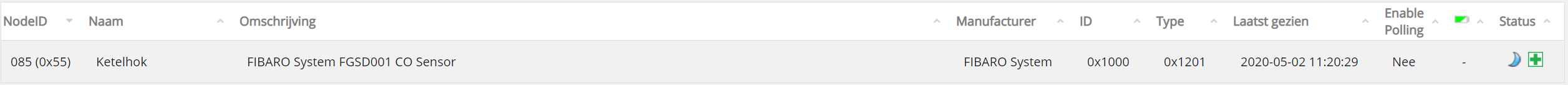

I am getting more and more frustrated with some of the Z-Wave stuff.
For example...This was on the 8th of April The temperature indicates that it was last seen on 24-03-2020 at 16:17:38
However, the controller has last seen the node on 08-04-2020 at 08:32:10 with a battery percentage of 55
Most frustrating is that all devices beneath it have been seen last in March or even in 2019!

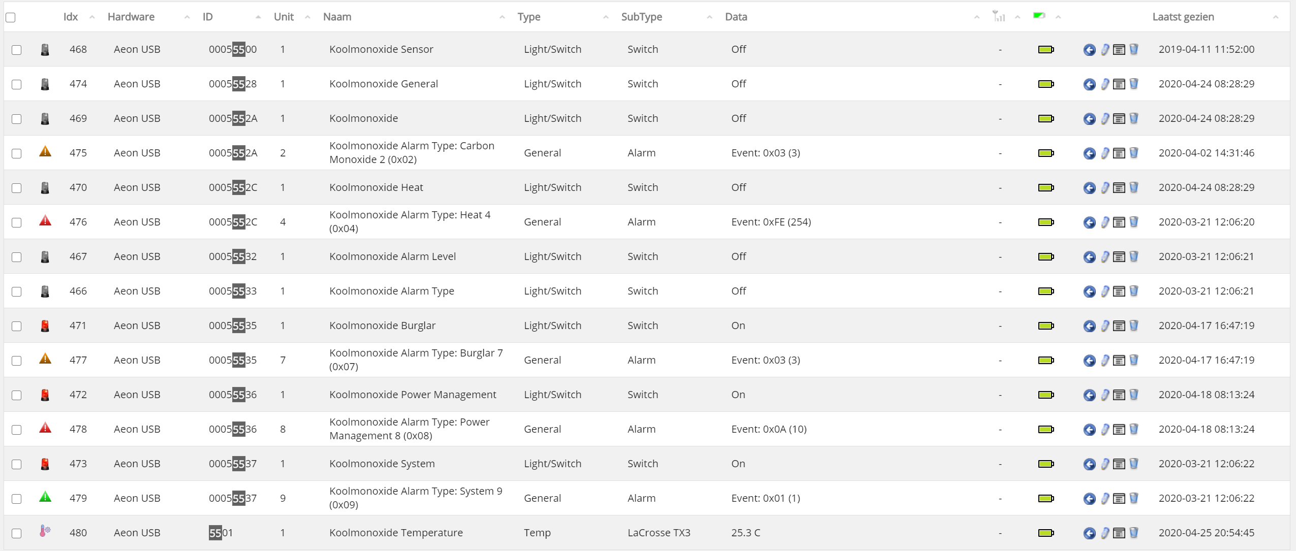

And one more example:
This way I am spending way more time maintaining my home automation than I should be.
In all fairness: the controller has also seen this device two days ago for the last time, so I am charging the battery for it.

Re: Domoticz Z-Wave issues
A hardware device can have several 'software' devices.
Not all of them get updated every time. Some of them only once when they are created.
Then next update when there is an alarm or so.
My Watersensor has 5 devices of which 1 is only updated when there is a water flood.
The same applies for my Smoke detector etc....
Did you look at the settings of your Koolmonoxide Temperature.
Mostly there are some settings controlling the behaviour of the device.
Including when a temperature should be updated.
In my Fibaro PIR there is a hysteresis setting for the Lux and temperature.
This is to avoid battery drain.
