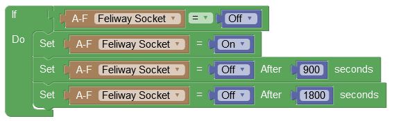

Dave21w
Posts: 431
Joined: Sunday 29 November 2015 21:55
Domoticz version: Stable
Location: UK
Re: Blockly Routines Randomly Stopping

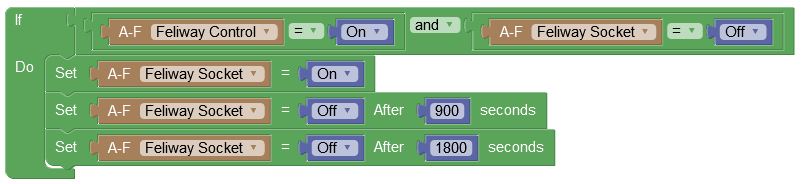

Post by Dave21w »
Here's the script, all it does is turn a mains socket on/off/on/off...... every 15 minutes, it worked fine before upgrading to 2020.* and now it randomly stops for no reason, since the stopping problem I have edited it only changing the first line and so far (fingers crossed) it has behaved however I don't see why removing the option to be able to enable/disable it from running using a dummy switch should make any difference.
