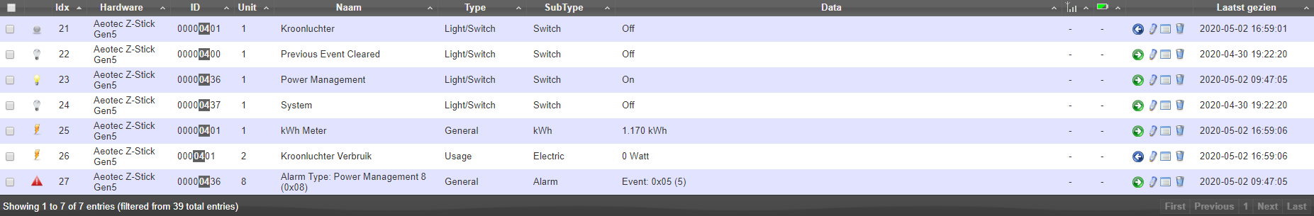

The following shows the devices in Domoticz (right-click image and choose open in separate tab to view in readable format):
Where device 21 is configured as a [Light/Switch] named 'Kroonluchter' and device 26 is configured as [Usage] named 'Kroonluchter Verbruik'.
